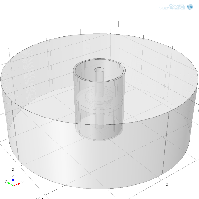

i want to calculate the current distribution and the magnetic field distribution of a moving conductor between two conducting disks. I'am interested in the outside magnetic field and the induced eddy currents in the conductive parts.
I'am using the Electric Current Interface(Ground BC and Normal Current Density BC) and the Magnetic Field interface (External Current Density Domain with ec.Jx, ec.Jy, ec.Jz).
I attached some pictures to clarify my needs:

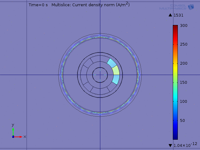

-> contactBolts_ringVarCondu.png shows the contact disks and bolts. A Normal Current BC is applied to the top bolt and a Ground BC is applied to the lower bolt. In between is a segmented ring. The conductivity of the segments will vary over time in that way that the resulting current path will describe a circle between the two contact disks.
-> complete.png shows the whole model with a cylinder jacket around the contact geometry and an surrounding air domain where the outside magnetic field will be measured.
-> eddyCurrentsCylJacket.gif this top view shows the induced eddy currents in the conductive cylinder jacket which are one part i'am interested of.
