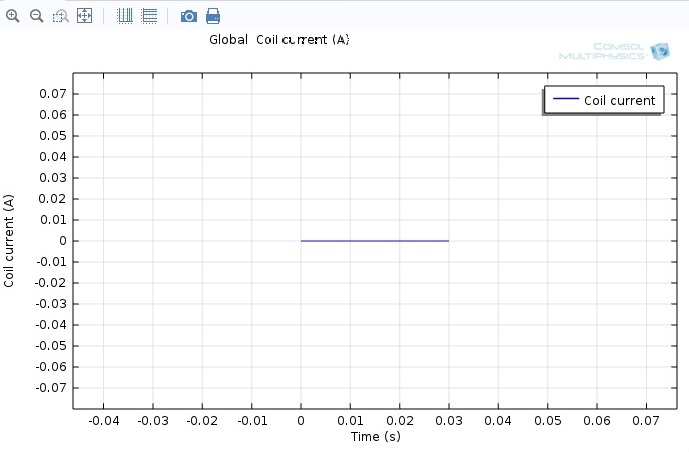

Anyone please have a view of the attached file (a simple microgenerator) and suggest me steps for the calculation of CURRENT in circular coil (preferably in Amperes or current density) and afterwards POWER in Watts. voltage is calculated here. I found this from a blog, in mine case coil is moving.
Problem which I am getting in attached file is a straight line at zero in plots section when i use coil current step.
I am in too much trouble because of my course project, kindly someone give me the favor, your few minutes can be greatly helpful for me.

In "Multi-Turn Coil 1" you set the coil current to be zero, so it is zero.

Immense thanks Jens for your kind response but since this is a case of microgenerator, as you can see the voltage is induced in coil. The end result I want is that "How much Power in Watts can be generated by the microgenerator" or can u please attach a file for my concept in which this type of task is done.
Secondly I put the value of current to zero by considering that its the case of micro-generator. If I use some value of current, that mean it will act as a motor.

Hallo Catalina,
you must consider how the multi-coil is connected to the outer word. It
really make the difference.
For instance if the coil is open, no current is flowing and your simulation
will give you as a result the induced voltage. This is the case in the mph-file
that you uploaded (which set current = 0).
The other extreme is to short-circuit the coil, this is done by setting voltage = 0
for the multi-coil. Then your simulation result is current.
If the circuit is more complex (I guess you have load in there) then you need
to include that in you simulation. Comsol can solve coupled systems with
finite elements and circuit.
How does the circuit look like in your case?

Thanks a lot lot dear Jens.
I was also thinking that without any load I can't get any value of current and you confirmed that. Thanks a lot for removing my confusion.
I am working on a generalized harvestor which can power any of the Ultra Low Power Mems Sensors, Circuit or any Microelectronics. In output I want Power or Power Density or such results related to generalized harvestor.
For overview: If you just view Table 1 in the paper:
Microelectromechanical systems vibration powered electromagnetic generator for wireless sensor applications Koukharenko Beeby Tudor
Although paper is a bit complex but I just have to go for the simple case, probably attaching any micro-sensor (since I dont have have the sensor in practical, also please suggest what load I should attach) and check the value of CURRENT and POWER corresponding to that. Since my concern is not to fabricate the device and check the results practically, I just have to simulate it.
