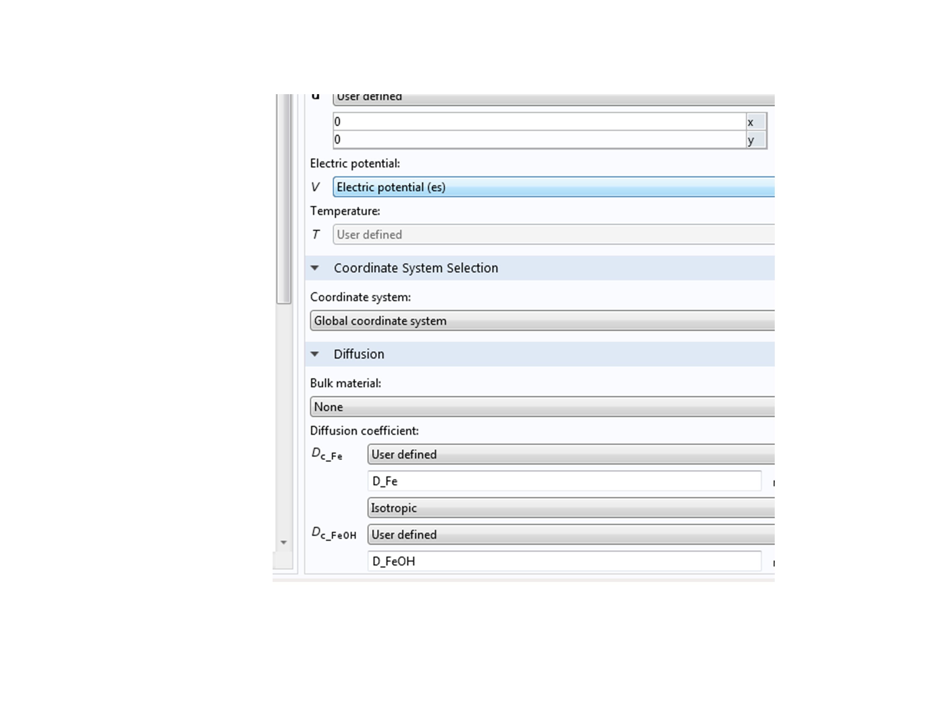

In the node Transport of Diluted Species you have to couple the voltage variable V from the electrostatics node, see figure.

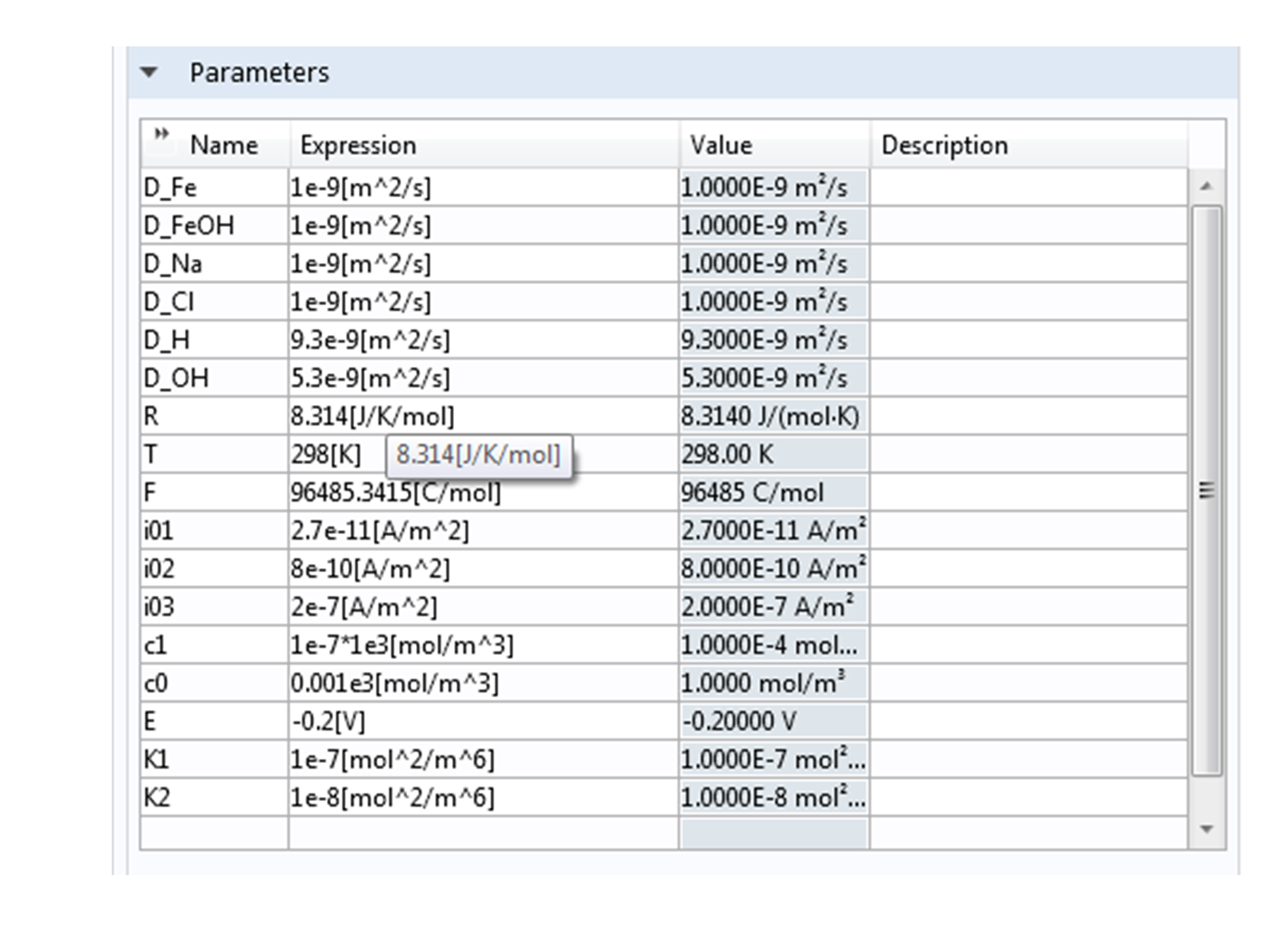

I have attached my model with units too. I will play with the value of io1 as you suggested.I have also attached a paper that I am trying to reproduce.
