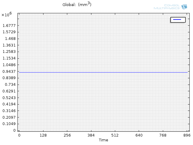

I later wanted to plot the isothermal volume in temperature ranges: 40˚C<T<50˚C vs time. I do this but get a straight line (attached). I used this on the expression section: intop1(40[degC]<=T<=50[degC]).
The graph I got has a constant volume with changing time even before the steady state condition but I expect the volume to increase with changing time.

Ejiro,
To calculate this volume use to following expression:
intop1(T>=40[degC])-intop1(T>=50[degC])
Sergei
Ejiro, To calculate this volume use to following expression: intop1(T>=40[degC])-intop1(T>=50[degC]) Regards, Sergei
