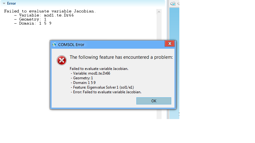

When I follow this paper "Thermoelastic Damping in a MEMS Resonator " to simulate my model with isotropic diamond material It showed good results. But when I changed to anisotropic diamond material I get error "Failed to evaluate variable Jacobian.
-Variable: Mod1.te.Dr66.
-Geometry:1
- Domain: 1 5 9
-Feature:Eigenvalue Solver1(sol1/e1)
-Error: Failed to evaluate variable Jacobian "
So here I attatched my file for the error and model.
I hope you can help me fix this problem. Thanks a lot.
Ha Dep
Hi Henrik, When I follow this paper "Thermoelastic Damping in a MEMS Resonator " to simulate my model with isotropic diamond material It showed good results. But when I changed to anisotropic diamond material I get error "Failed to evaluate variable Jacobian. -Variable: Mod1.te.Dr66. -Geometry:1 - Domain: 1 5 9 -Feature:Eigenvalue Solver1(sol1/e1) -Error: Failed to evaluate variable Jacobian " So here I attatched my file for the error and model. I hope you can help me fix this problem. Thanks a lot. Regards, Ha Dep
