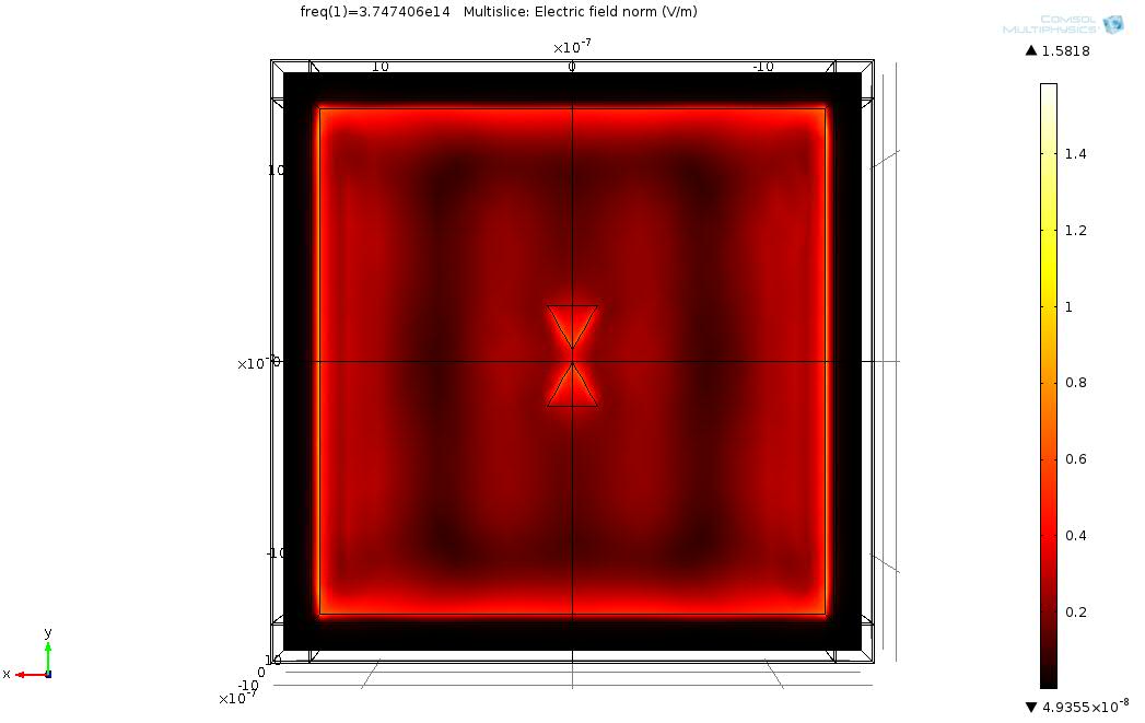

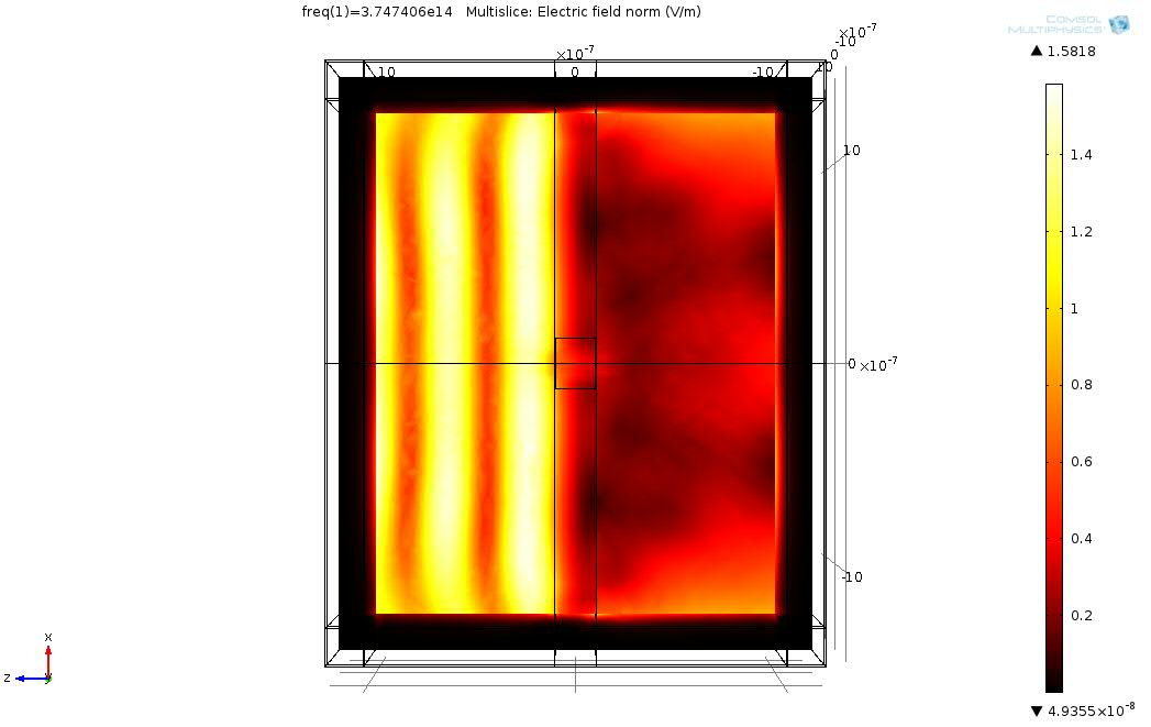

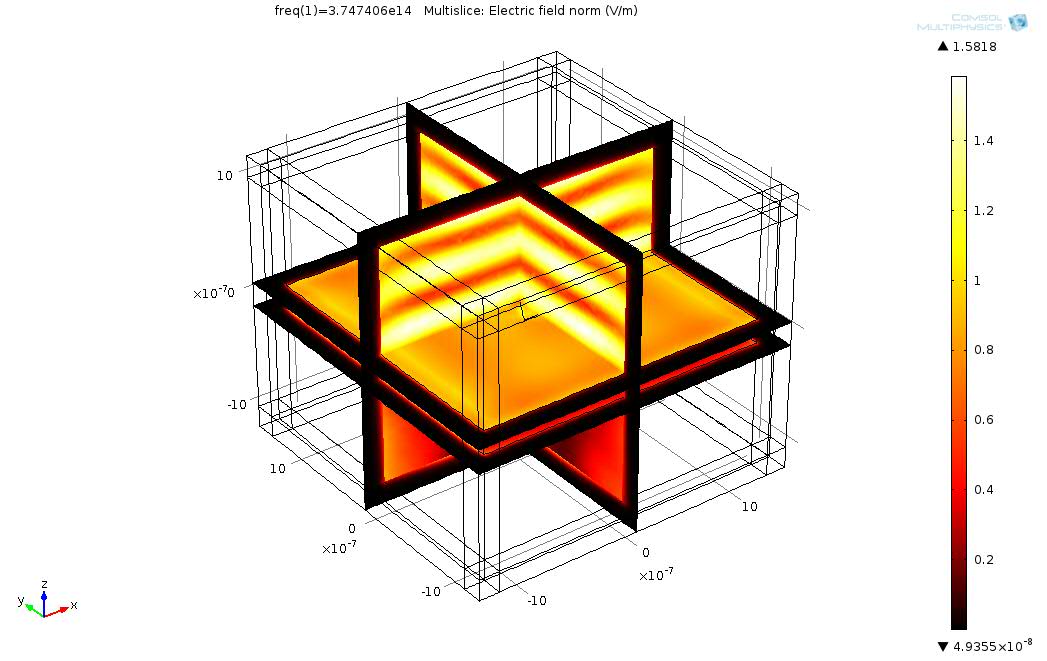

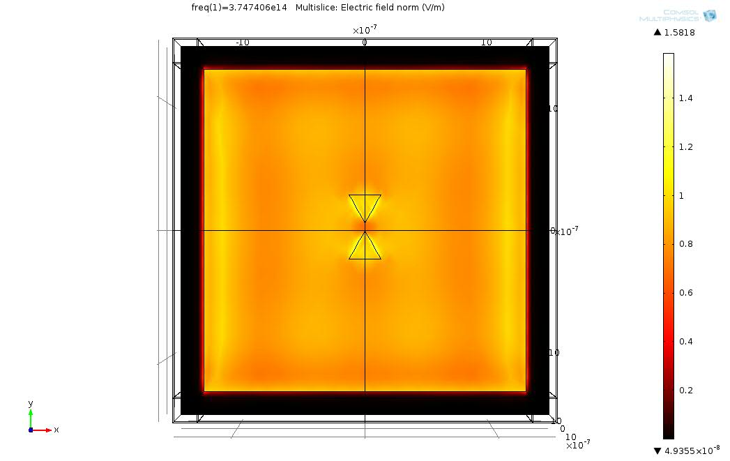

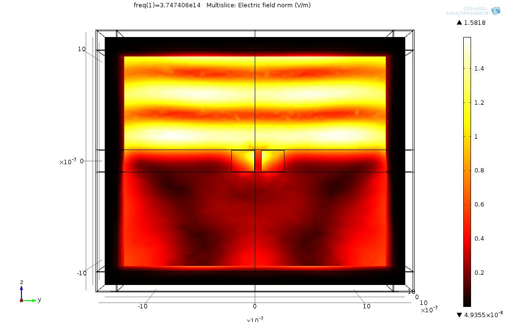

Both models showed suspicious results as can be seen in the figure attached.
1. I get light coming from the PMLs.
2. Fringes on the top and bottom metal surfaces. They are polarization dependent. I think they are surface-plasmons created on the edge of the metal slab, but we want to simulated an "infinite" metal layer.
