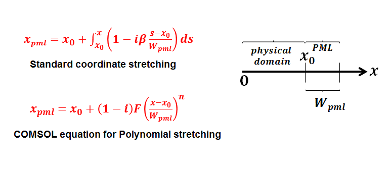

The coordinate stretching COMSOL uses seems a bit different from the standard ones I have seen in the literature (please see the file attached). It looks like COMSOL scales both real and imaginary part. However, I have no idea how the rational stretching works (the equation is more complicated) ! The F (comsol) and beta (standard) work as the absorbing coefficient.

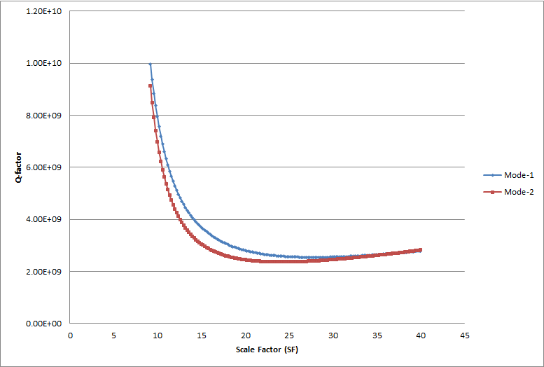

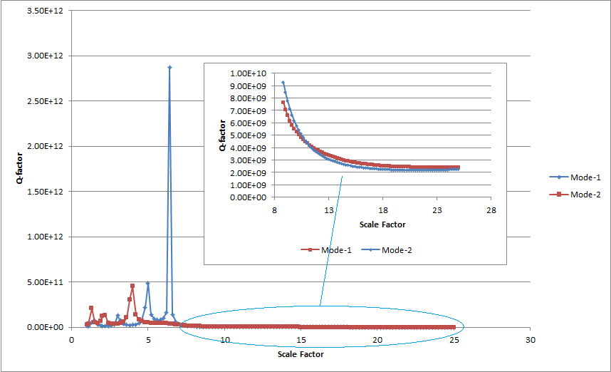

Thanks for you reply. I have attached a graph of my Q-factor vs scale factor. Generally the two modes are expected to have similar Q values. But there's a difference between two Q values initially. As SF is increased further two values become similar BUT you could see the divergence of the two curves. I hope you could give some suggestion on that.

What you show in your graph is, I suppose, the expected behavior for a PML:
If you put a low scaling factor, it is similar to put a low-absorption boundary condition. Then the outgoing waves will go in and out of your PML causing spurious reflections.
If you put a high scaling factor, it is similar to put a very-absorptive boundary condition (high conductivity) and it will behave as a metal, which will translate also in spurious reflections.
PML success, as in live, depends on having the exact amount of each ingredient... that is why PMLs are perfect :)
There are lots of papers about how to tune the PML parameters. I dont know any of them applied to the area of MEMs or Structural Mechanics, but I'm sure a simple search will lead you in that way.
If I were you, wouldn't waste more time and start using a scaling factor between 35 and 40.
good luck with your experiment,
Felipe BM
