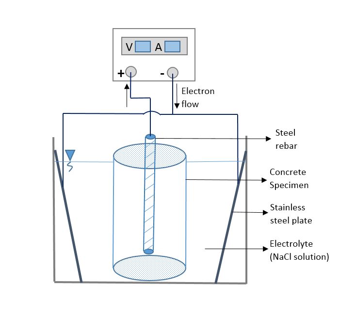

Posted: 9 years ago 2 mar 2016, 00:53 CET
Dear Lasse Murtomäki,
Would you please guide me what is the exact meaning of “the electrode potential (phi L)” and “electrolyte potential (Phi S)”?
Let me make my question clear:
I am trying to model an accelerated corrosion test on steel rebar embedded in concrete cylinder. In this test I am applying a potential of 10V by a DC power supply to the anode (steel rebar) and cathode (stainless steel plate which is placed outside the cylinder in a 5% salt solution (electrolyte)) - I don't exactly know what the potential is in the salt solution, I can just measure the applied voltage and current (A) through the circuit - please see the attached picture.
1- My first question is; what modulus is proper to model an Accelerated Corrosion Test: AC/DC Modulus or Secondary Corrosion Modulus or ... ? (Please note that I am not going to model a natural corrosion)
2- I am going to calculate the expansion due to the rust formation around the rebar and then calculate the concrete cracking due to this phenomenon, is COMSOL able to model rust formation and expansion around the anode?
3- Is there any practical example that I can use it as an initial guideline (please note that I have already seen the "Cathodic Protection of Steel in Reinforced Concrete" example, this is not really relevant to my test since it is just considering the concentration and diffusion of concrete – not any rust formation or mass loss)
Sincerely Yours,
Hamid
Dear Lasse Murtomäki, Would you please guide me what is the exact meaning of “the electrode potential (phi L)” and “electrolyte potential (Phi S)”? Let me make my question clear: I am trying to model an accelerated corrosion test on steel rebar embedded in concrete cylinder. In this test I am applying a potential of 10V by a DC power supply to the anode (steel rebar) and cathode (stainless steel plate which is placed outside the cylinder in a 5% salt solution (electrolyte)) - I don't exactly know what the potential is in the salt solution, I can just measure the applied voltage and current (A) through the circuit - please see the attached picture. 1- My first question is; what modulus is proper to model an Accelerated Corrosion Test: AC/DC Modulus or Secondary Corrosion Modulus or ... ? (Please note that I am not going to model a natural corrosion) 2- I am going to calculate the expansion due to the rust formation around the rebar and then calculate the concrete cracking due to this phenomenon, is COMSOL able to model rust formation and expansion around the anode? 3- Is there any practical example that I can use it as an initial guideline (please note that I have already seen the "Cathodic Protection of Steel in Reinforced Concrete" example, this is not really relevant to my test since it is just considering the concentration and diffusion of concrete – not any rust formation or mass loss) Sincerely Yours, Hamid
