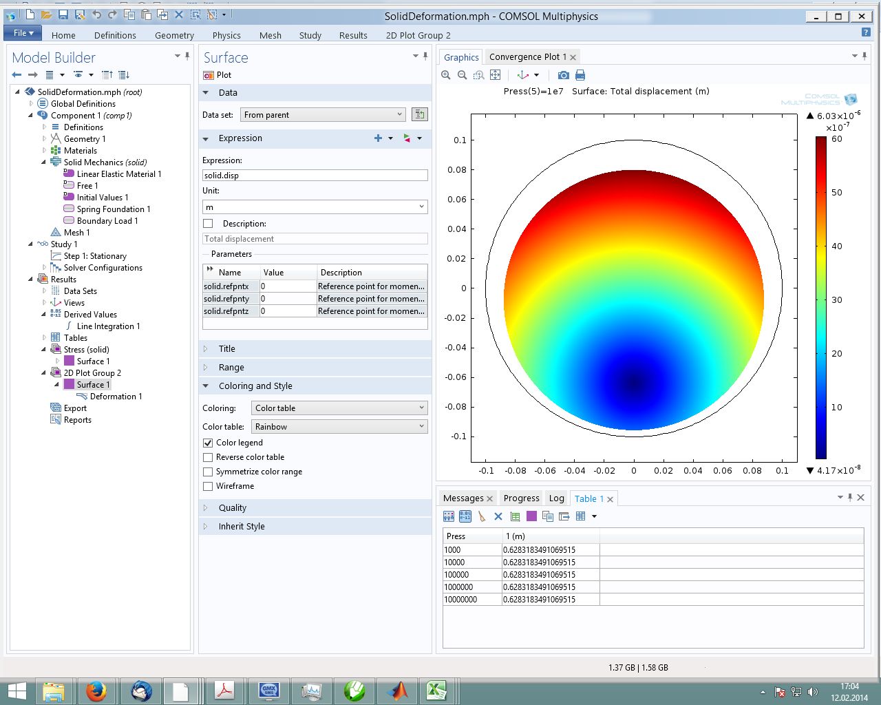

I used a simple 2-D geometry of a solid material.
I used "solid mechanics" module and applied different external pressures to the material.
As expected the material was deformed under ther external pressure.
But .....
I now I try to calculated the changed volume of material.
An interpretation in the postprocessing indicates constant surface of the material.
I used "Results/DeriveValues/line integration" and applied it to the expression "1". I expected the integral to be the length of the way = the surface of the body.
But it result sticks to the original length without pressure, independend of the applied external pressure.
Any ideas?

OK, I now understand that I need to observe two points:
... 1) I need to tag the "include geometric nonlinearity" in the node: "Study/Stationary/"
... 2) I need to change the integration way of the linear integral from "material frame" to the "spacial frame".
But how do I select the frame for the line integration?
- I go to the node: "Results/Derived Values/Line integration".
- There I choose "All Boudaries" to complete the circle as the integration way.
- I set the "Expression" to be "1".
- In the Parameters section I see but cannot modify "solid.refpntx,solid.refpnty,solid.refpntz".
___So: I don't see how and where I can choose between "material frame" to the "spacial frame" for the integration way.___
