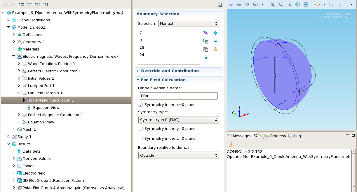

Bartek,
PMC is an appropriate boundary condition to account for symmetry plane. To get correct radiation pattern with symmetry plane, you need to impose the same symmetry boundary condition for the Far-Field Calculation: under Far-Field Domain>Far-Field Calculation node, check Symmetry in E (PMC) box and choose appropriate plane.
Attached is model for the dipole antenna with symmetry plane and comparison with analytical solution.
Sergei
Bartek, PMC is an appropriate boundary condition to account for symmetry plane. To get correct radiation pattern with symmetry plane, you need to impose the same symmetry boundary condition for the Far-Field Calculation: under Far-Field Domain>Far-Field Calculation node, check Symmetry in E (PMC) box and choose appropriate plane. Attached is model for the dipole antenna with symmetry plane and comparison with analytical solution. Best regards, Sergei

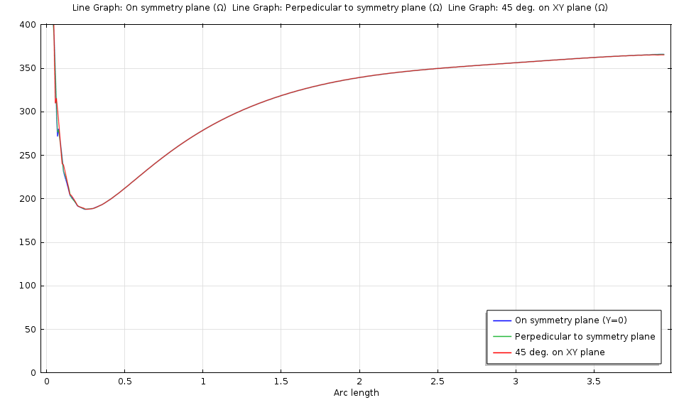

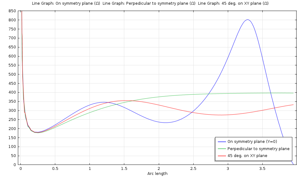

I've tried to recreate a dipole model with symmetry. To confirm that it is correct I've used E/H relation.
You can see the results attached. It can be seen that while the full model conforms the theory that a dipole should have stronger electric field in the near field which will reach a minimum and then increase towards the impedance of free space. I'm not sure how to interpret the results from the model with a symmetry.
If you want I can provide you with Java files with the simulations.
Bartek Chaber
I've tried to recreate a dipole model with symmetry. To confirm that it is correct I've used E/H relation. You can see the results attached. It can be seen that while the full model conforms the theory that a dipole should have stronger electric field in the near field which will reach a minimum and then increase towards the impedance of free space. I'm not sure how to interpret the results from the model with a symmetry. If you want I can provide you with Java files with the simulations. Best, Bartek Chaber
