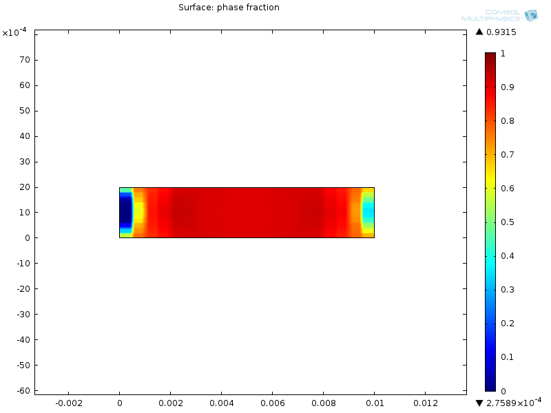

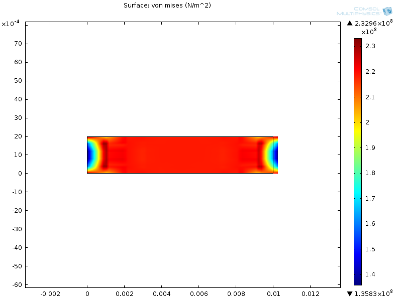

So far, we have implemented the model and it works properly for simple geometries. If we start with a block of material in phase A and ramp up the strain in x-direction at constant ambient temperature, the phase fraction Xi will go from 0 to 1 above a certain critical stress and the sample will heat up due to latent heat. (See attached plots stress.png and phasefraction.png)

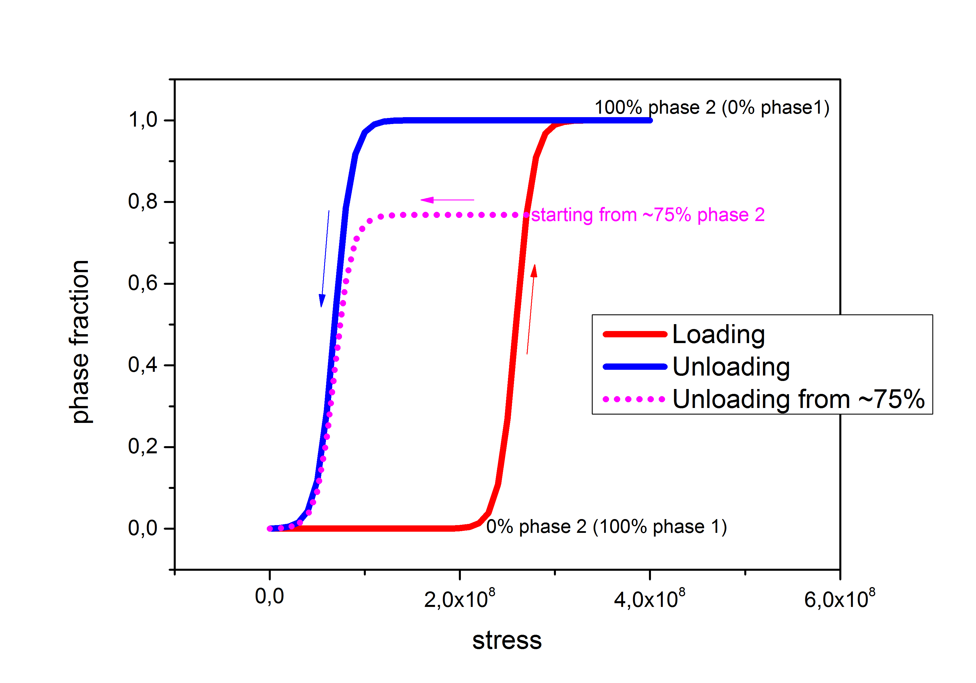

However, the real material behavior includes hysteresis and this is where our problem lies. There are actually two functions f_AM(T,stress) and f_MA(T,stress), one describing the A->M transformation, and the other the reverse process (M->A), respectively. The parameters k0, T0 and c are not the same in both cases. Also, the material behavior becomes history-dependent. If we again consider a sample of 100% A-phase and ramp up the strain linearly in time, the M phase fraction will increase according to f_AM(T,mises). We can stop (for example) when only 25% of phase A is left (Xi=0.75) and ramp the strain down again. Now, only 75% of the material can take part in the M->A back transformation (described by f_MA(T,mises)), because 25% already are in A-phase. (Compare attached file Graph1.png)
