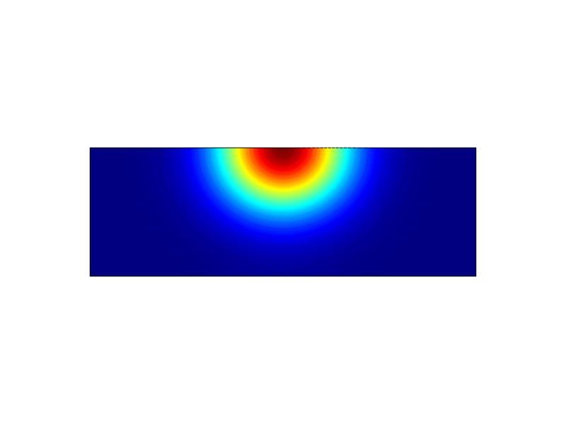

I have very simple model where copper plate is heated by a pulsed laser (transient study, 2D, see file surfaceplot_1).

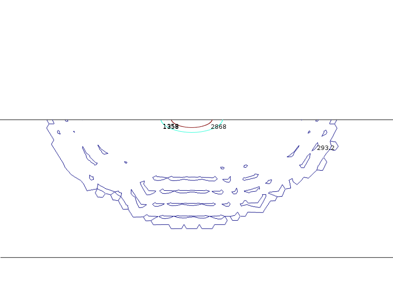

I know that I can plot defined isothermal curves in a contour plot and than manually extract the position of the the curve at a corresponding position for each time step which is however very inefficient (see file contourplot_1).
