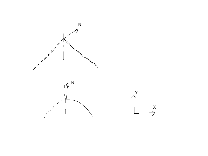

a) The symmetry plane is not aligned with an axis of the local edge system. This is the upper case in the appended sketch (where YZ is assumed to be a symmetry plane and the shell stretches out in the Z direction.)
b) Due to curvature, there may be a small error in the computed direction. This error will decrease with mesh density, and can often be ignored. This is the lower case in the appended sketch.

Thanks for the reply, but does the N in the sketch represent a normal to symmetry plane?
Since symmetry plane is defined on a boundary, why the symmetry plane is not aligned with an axis of the local edge system? (one of the axis of local edge system is tangent to the edge)

N indicates the normal to the shell. The symmetry line is the vertical dashed line. In the case in the lower sketch, the shell normal N is mathematically in the Y direction, but numerically not because of the discretization.
In the sketch, the shell edge in the symmetry plane goes in the Z direction. So the symmetry plane can have any rotation with respect the edge tangent. For most cases, however, the second axis of the edge tangent system coincides with the normal to the symmetry plane (at least mathematically).
