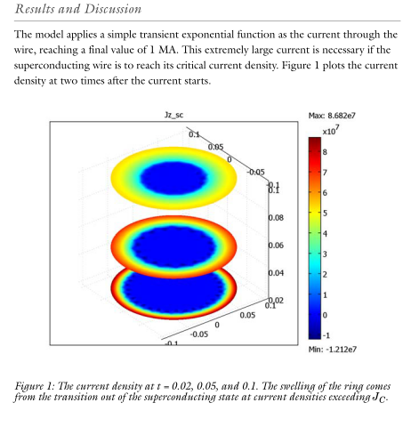

Is there a possibility in 4.3a version, to get some kind of section through, for example magnetic field images in selected time steps?
I mean, like it was made in the picture in attachment.

you can create the additional data set "Parametric Extrusion 2D" to be found by right-clicking "Results > Data Sets" under "More Data Sets". Here you can extrude a 2D data set in the time domain and specify, which points in time you want to choose. Afterwards, the data set can be plotted in a 3D Plot Group.

Thank you Ms Schieche,
that helps me a lot.
