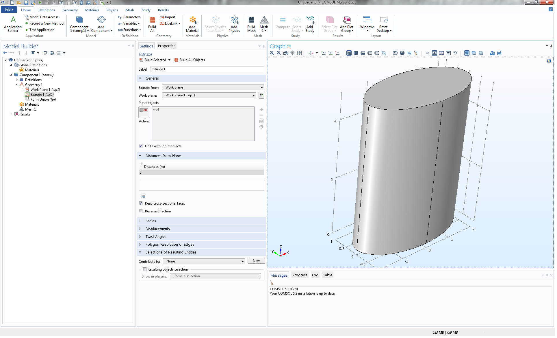

You can draw an ellipse in a workplane and extrude it.
You can draw an ellipse in a workplane and extrude it. Best regards, Jeff
Posted: 9 years ago 9 giu 2016, 03:15 CEST
It works. Thanks a lot!
