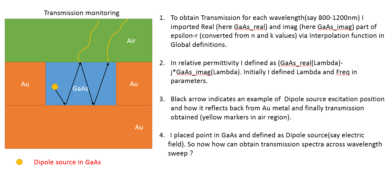

Actually Now I had imported Refractive index values via interpolation. I had converted n and k values to Relative permitivity say GaAs_real and GaAs_imag.
Previously in Parameters I had defined Lambda = 1000 and frequency = c_const/Lambda[nm]. I had used nm in Lambda since imported (ex. GaAs_real) wavelength values as say 800 ..... without nm.
In GaAs Material properties I had defined Relative permittivity as = GaAs_real(Lambda)-j*GaAs_imag(Lambda). I think this is correct definition.
So In Parametric sweep now I can do Lambda dependent.
(I had attached the concept of my simulation as picture where you can understand my idea)
My Goal is to get PL spectra (may be Transmission ) vs wavelength. I had placed Point in GaAs and used that as Dipole source. My target is to achieve Transmission spectra coming out from GaAs vs wavelength (say 800-1200nm). I m really confused here how-to-do. For obtaining transmission spectra do I need to use port condition or what ?
Certainly, you could put a boundary probe on the top air boundary to record the transmitted field, but there are several questions to determine. It is far enough away from the GaAs/Au structure to form a uniform field appropriate for retrieval? How do you determine the baseline "incident" power from a point dipole inside a small structure (i.e. in the near field)?
I've set up a short example that is probably not very accurate, but at least demonstrates the challenges of trying to do what you have requested. I set up a boundary probe on both the air and the GaAs/Air interfaces, as well as a point domain probe placed near the dipole. The results of the normalized and averaged power transmittances are shown in the global 1D plots, and show the discrepancies between using the GaAs/air boundary and the point probe.

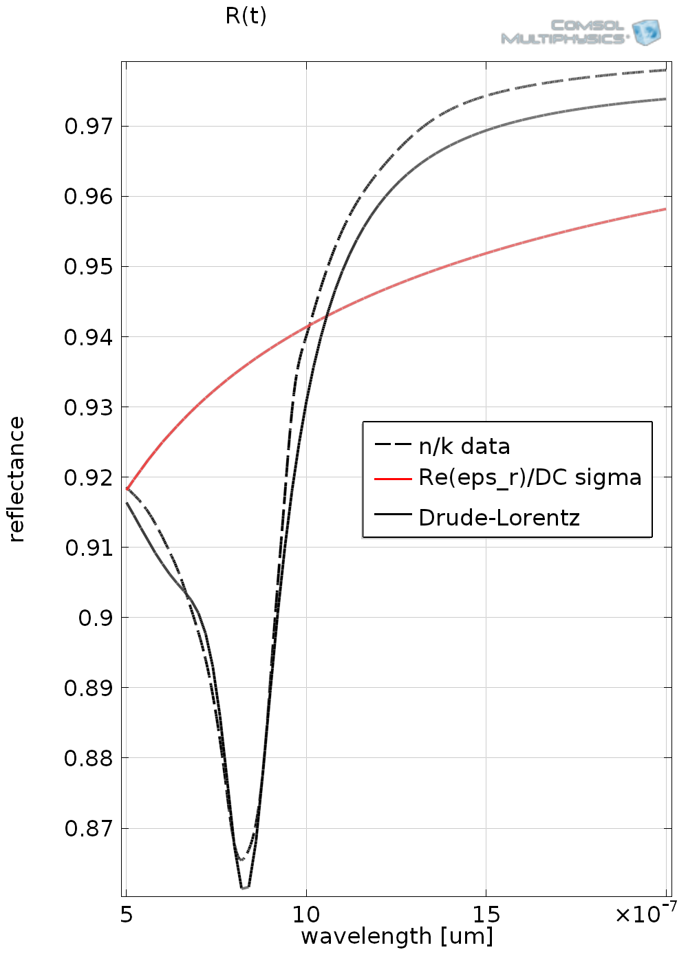

From a test of several different displacement field models, I have found that for gold or aluminum in the optical regime, the only way to accurately match n/k data is to use the Drude-Lorentz model (out to five oscillators), defining eps_infinity as 1-(f0*omega_p^2)/((2*pi*freq)^2-i*(gamma_p*2*pi*freq)), with f0 the high frequency oscillator strength, and omega_p and gamma_p the plasma and damping frequencies, respectively. I've attached a graph of using three different models and measuring the well-known reflection of aluminum in the optical regime. The n/k and Drude-Lorentz models match well, but the relative permittivity model, using a real eps_r and a DC sigma, do not, because it does not account for the optical transitions. I will upload the model so you can play around with different methods, too.
