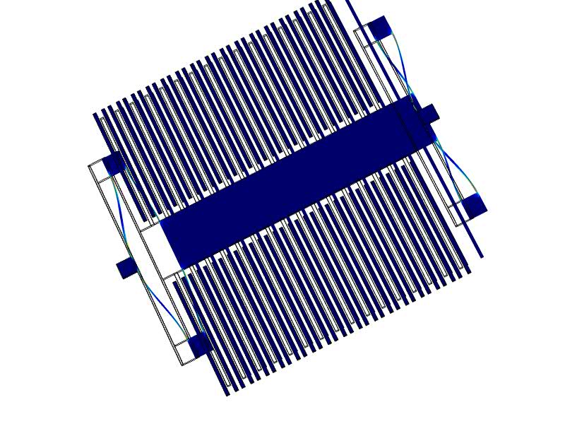

I use Solid mechanic study and add force -a*solid.rho at x axis of the body load. I attached the pic (noacc) of the result as well
i choose this study to see how much stress can the device received. But from the pic you can see the spring is becoming really twisted and i'm not sure is it supposed to be that way.

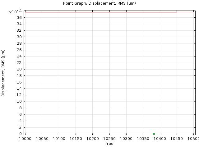

From here where can i get the resonant freq?

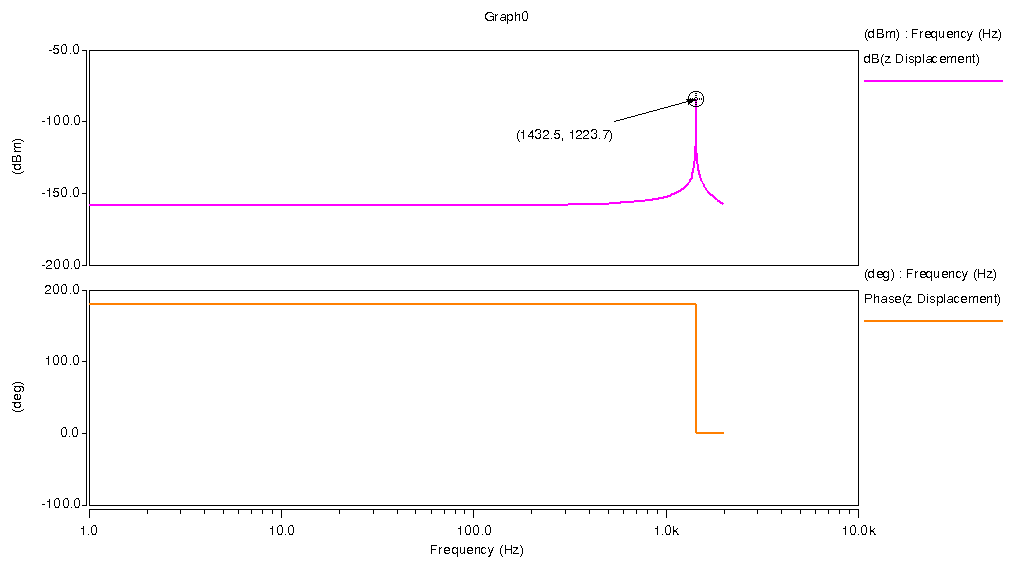

i could not get the any result for the frequency domain when i tried to get displacement vs freq result. see simresult picture. i thought the curve should be like in pic freqresult
i don't know if i set it wrong somewhere.
