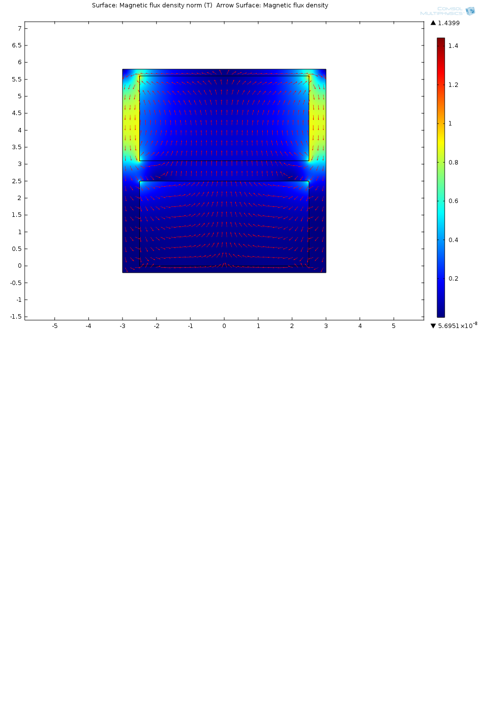

hello, i want to make a permanent magnet, and see the magnetic flux density norm using arrow surface. i found a picture of a magnet, see attached photo, but i need to know how i can make this, because i need similar magnets for another project. i've been trying different methods but so far it has been unsuccessful. please can someone help me.?

Hello!
You can add an extra Ampere's Law in your MF or MEF model, select your magnet domain, switch the Magnetic field to Remanent flux or Magnetization and put in a value.
This will produce a Permanent magnet.
Ralf
Hello! You can add an extra Ampere's Law in your MF or MEF model, select your magnet domain, switch the Magnetic field to Remanent flux or Magnetization and put in a value. This will produce a Permanent magnet. Ralf

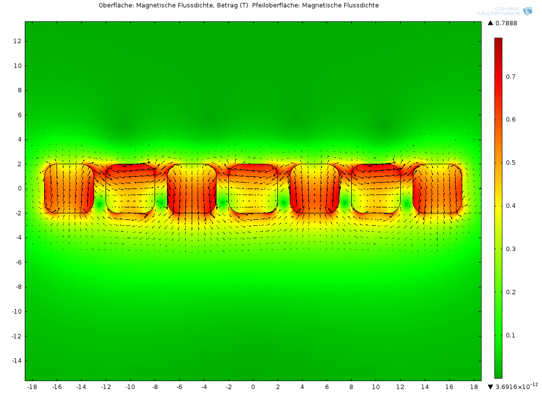

Plz let us know that And if i want to implement halbach for 7 pieces of 16 x 4 mm, how can i assign field lines into and out of the paper?
And let us confirm that while applying amperes law, I should divide 16 x 4 into two pieces and assign each piece say 5000 A/m in magnetization in x and y? Kindly confirm that. And also that how can I assign flux lines into and out of the paper (I mean by that field lines from top to bottom and bottom to top assigning)...

Hello!
You can use my example for a Halbach array; this is in 2D.
So I don't know, what do you mean with "flux lines in and out of the paper"...
In 2D this is not possible.
Ralf
Hello! You can use my example for a Halbach array; this is in 2D. So I don't know, what do you mean with "flux lines in and out of the paper"... In 2D this is not possible. Ralf

Hello!
My version is 4.3b, as you marked above...
I use remanent flux density; rotating direction from piece to piece:
first piece: +1.2T in y direction, second piece: +1.2T in x direction, third piece: -1.2T in y direction and fourth piece: -1.2T in x direction and so on...
Other properties are sigma=1S/m and epsilon_r=1.
Ralf
Hello! My version is 4.3b, as you marked above... I use remanent flux density; rotating direction from piece to piece: first piece: +1.2T in y direction, second piece: +1.2T in x direction, third piece: -1.2T in y direction and fourth piece: -1.2T in x direction and so on... Other properties are sigma=1S/m and epsilon_r=1. Ralf

I have attached the image below, I assigned remenant flux in accordance to ur instructions.
