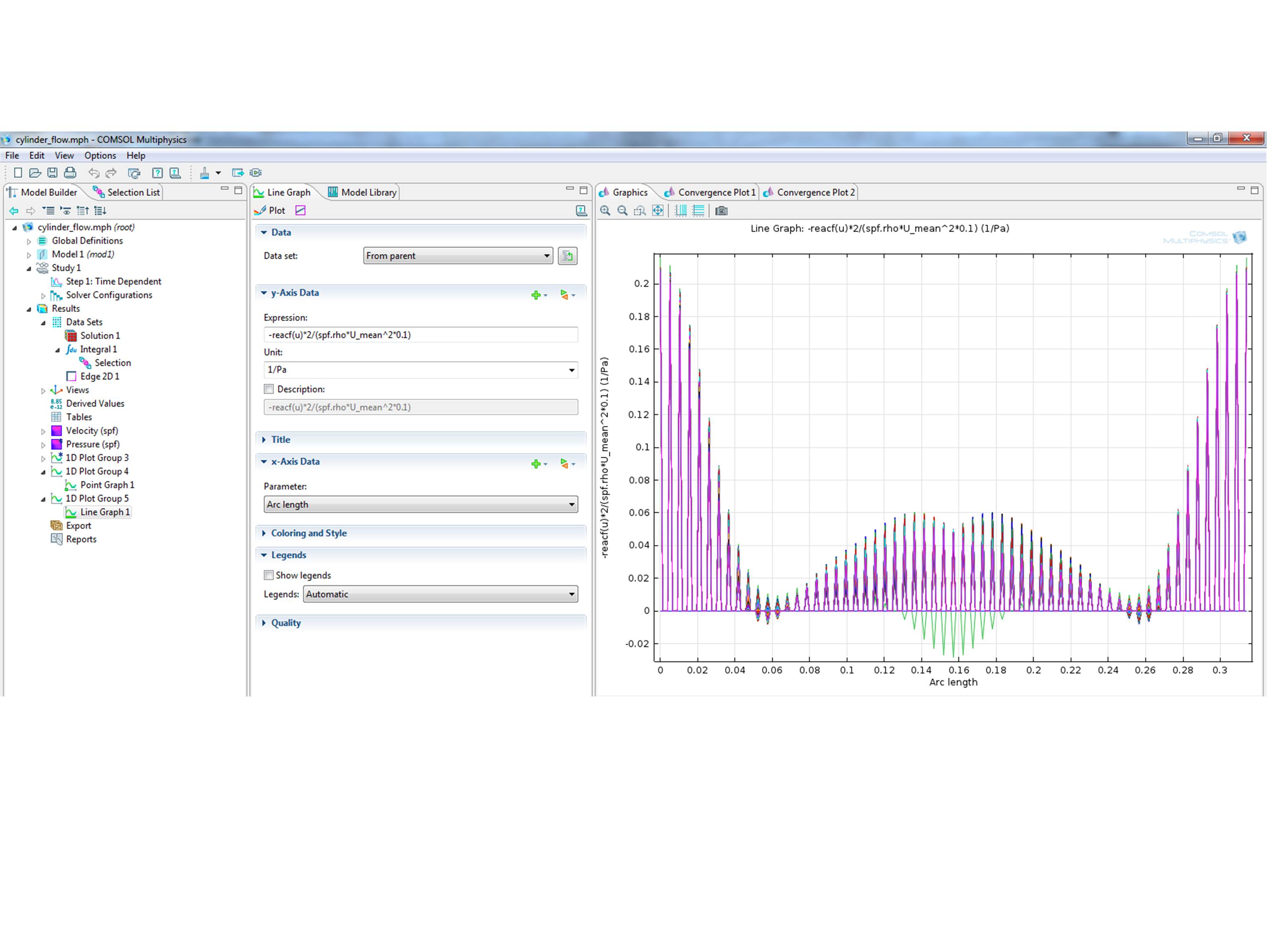

Just for fun, I defined "Edge 2D 1" as the circumference of the cylinder, created a "1D Plot Group 5" and plotted the drag coefficient along the circumference at all time points, see the attached figure.
I am not sure if I am helping at all...
BR
Lasse
