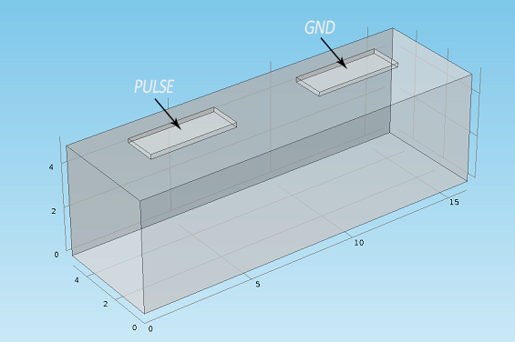

Thank you for your response. I'm actually trying to model a scenario of charge balancing. So assume two electrodes dipped in a saline solution. One electrode is grounded and the 2nd electrode is supplying a bi-phasic voltage pulse to the system (Ex pulse: www.frontiersin.org/files/Articles/12119/fneng-04-00009-HTML/image_m/fneng-04-00009-g001.jpg). I would like to visualize the charges in the saline solution with time. The goal is to see some unbalanced charges around the electrodes if the positive area of the pulse is not equal to the negative area of the pulse. (www.nervestudy.com/wp-content/uploads/2013/03/image013.jpg)
I've attached a sample model just with the EC physics.

I'm not sure I understand why your graphics window turns black. Here I've attached picture describing the model, it's nothing but three cubes. bottom surfaces of the electrodes touch the top surface of the cube that represent the saline. I know the dielectric values for saline are not correct. The values I used were some random values used for testing purposes.
Could you please help me set up the correct modules to do the simulation. I'm not sure I understand how to setup the primary current distribution. I was under the impression that 'electric current' module with 'diluted spices transfer module' would suffice to do the simulation.

I wish you can open this; I am using version 5.0. I did no see the solution as my graphics window is black, but please tell me how it looked :)
In the Transport of Diluted Species, activate migration, inactivate convection. Choose Electric potential as "Electric potential (ec)".
Notice my changes in the time stepping and relative tolerance, as well as the diffusion coefficients and charge numbers, they correspond to NaCl. Concentration is 0.3 M, ca. the ocean salinity.

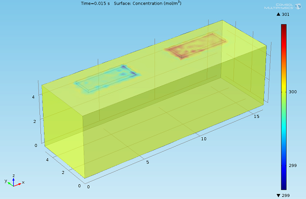

Hello Lasse,
The file did not open in version 4.4. Luckily I had access to a trial of version 5 and using that I was able to replicate the physics. Simulation works exactly as I expected and this solves most of the problems I had. Thank You so much for your help.
P.S. one of the resulting plots is attached.
Saliya K.
