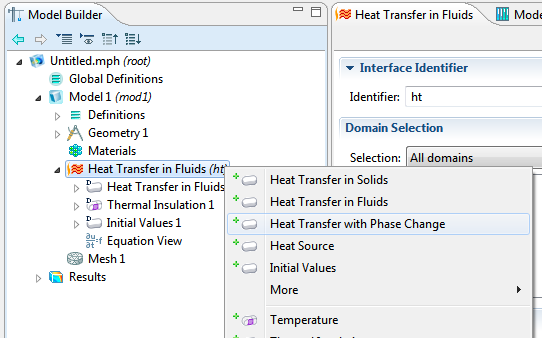

where is the icon to add heat transfer with Phase change
I was going through one tutorial on heat transfer through phase change. In the menu under heat transfer in fluids i could not find heat transfer with phase change? Is it related to the version.

Dinesh,
What version are you running?
New in Version 4.3b you can add "Heat Transfer with Phase Change" as a domain physics condition to Heat Transfer analyses.
See attached screenshot from v4.3b.

Dinesh,

Sir
i am running 4.2a and 4.3 but both of these version dont have that option as i showed in the screenshot. Is it bcoz of version only. How can i add (phase change) in my version

Hello Dinesh
"Heat Transfer with Phase Change" is a feature that is unique to the Heat Transfer Module (see www.comsol.com/products/specifications/heat-transfer/), so your screenshot suggests that you do not currently have that Module. You can check which Modules your license carries by going to the Options > Licenses menu.
