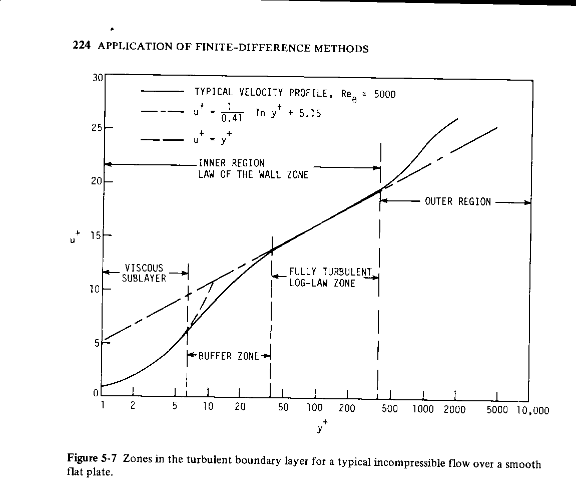

Also Rey=10^6 is quite large. Turbulence theoretically starts at ~ 1200. So, if you really have Rey=10^6, you should have an extremely thin boundary layer and very small value for wall offset and very fine mesh near the wall. Yes the answer is questionable if you don't have 30<y+<100. This is clearly stated in the COMSOL manual. You need to have a benchmark problem in hand similar to yours to judge the accuracy. Yes, the literature is full of these problems.
I am attaching one of my favorite figures on this topic. It is on page 224 of "Computational Fluid Mechanics and Heat Transfer", McGraw-Hill, 1984, Anderson, Tannehill, Pletcher.
