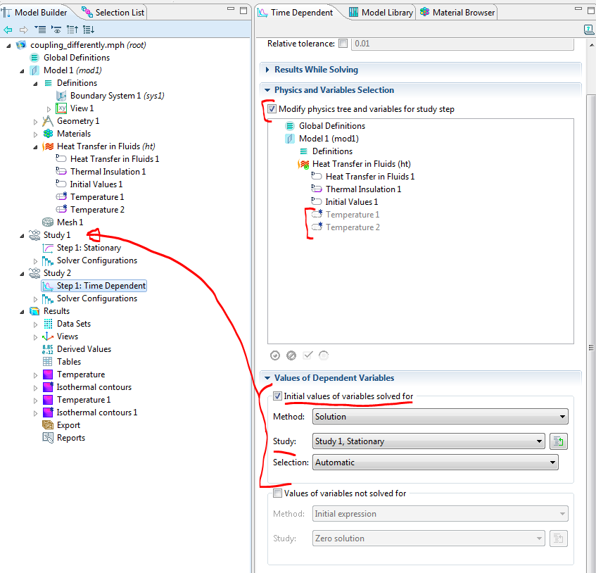

Not sure what your question is in the end, but I attached a model which shows how to use a result from a different study as initial value for your transient calculation.
The screenshot shows the most relevant settings in this case.
In short, you use the results from a different study as initial values. In study 2, you disable the boundary conditions for the temperature.
If this is not what you intended, please explain what you want to achieve and why. There might be multiple ways to solve this.
