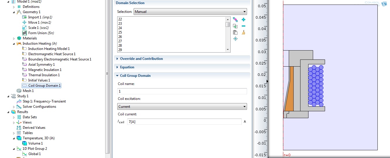

In this assumption multiturn coil, you neglect the eddy current in the winding.
In the field area, it is the area of one turn coil and not the total one.
Jean-Marc
This assumption is right when the skin depth is around the diameter of the one turn coil.
It's necessary to use coil group domain and describe all 77 turns.
In this cas you consider all the turn in series.
It's very simple with the menu transform > array of the geometry nodes.

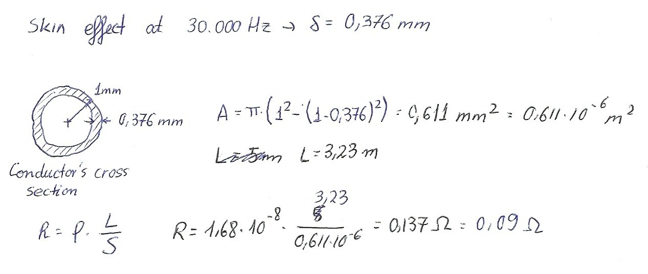

For 30kHz the skin depth is 0.37 mm. So the effective area on the conductor will be a ring near the surface of the cable.
The effective area should be:
S=pi*(Rout^2-Rin^2)= pi*(1^2-(1-0.37)^2) =1,89 mm^2
The length of the coil is aprox. 3,23 meters so:
R=rho*L/S = 1.68e-8 * 3,42/1,89e-6 = 0.0304 ohm.

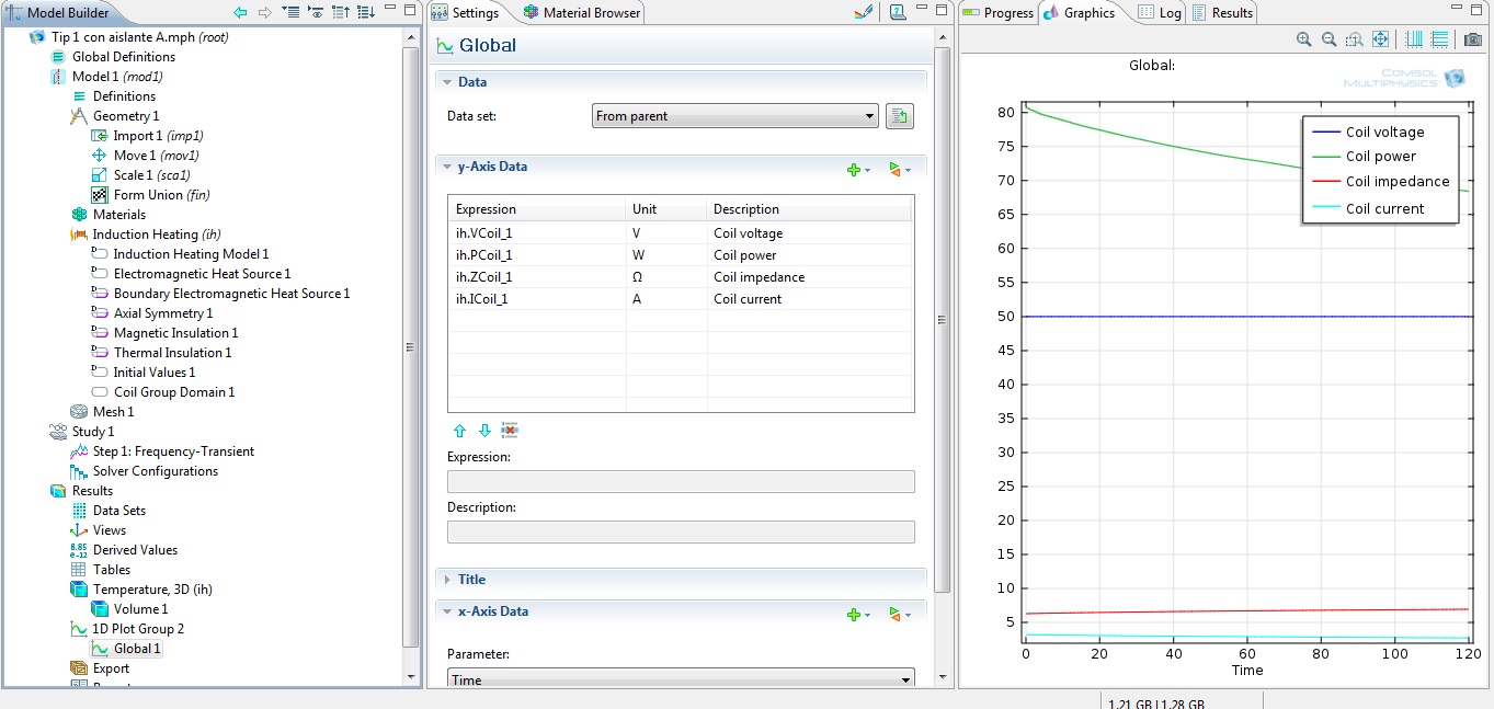

But when i simulate i get a resistance of 5 ohms.

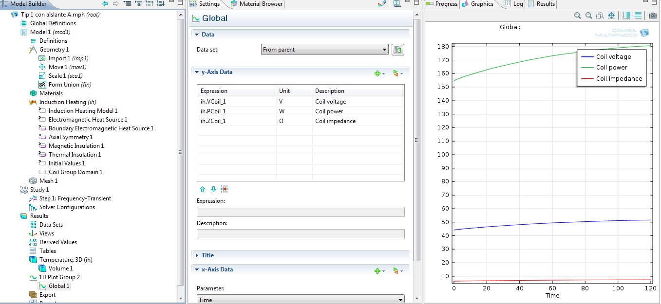

On the other hand, when I use the current for the coil excitation the programs calculate the other coil parameters such as coil voltage or coil power. Is I use that coil voltage for the coil excitation i get completely different results.
The final temperature using current is 270ºC. The temperature using voltage at the same time is 140ºC
The resitance compute by COMSOL is a global resistance taking into account the susceptor inside the coil.
If you want to compute only the copper resistance, you must integrate resistive heating only in the coils, and with the currents or voltage deduce the copper resistance.
Jean-Marc
It's the equivalent resistance of your tal circuit and same thing for the inductance.
Your total system is equivalent to a Requivalent and Lequivalent in series.
Jean-Marc
With the equivalent resistance you can deduce the total active power (power generator) and with the inductance the total reactive power.

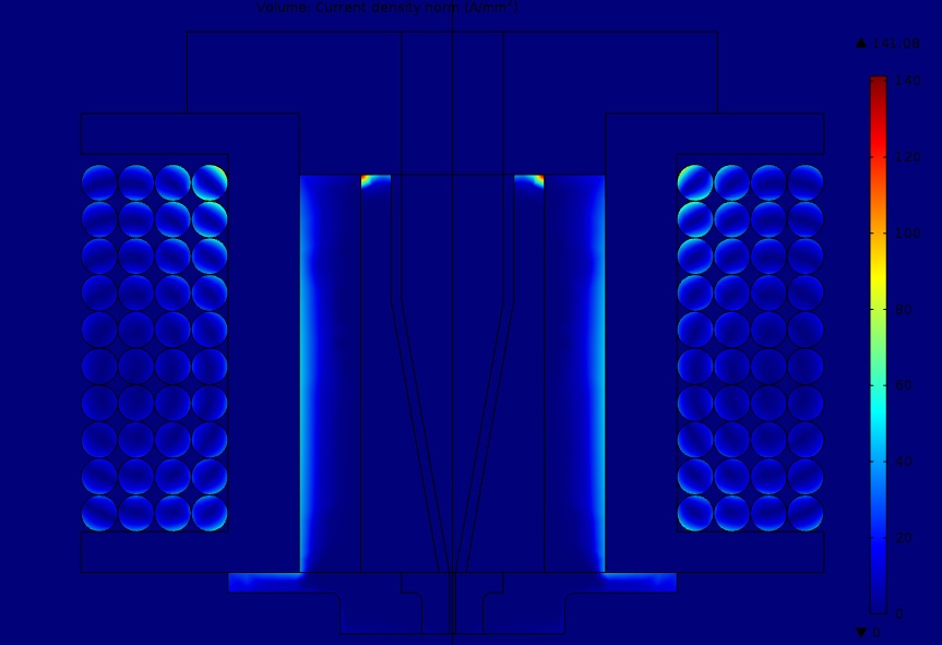

The effective area of my coil is A=1.68 mm^2 (1.8 diameter wire; 30kHz), the equivalent coil with that area is the AWG 14, which can resist 5.9A, so the current density would be 5.9/1.68= 3.62 A/mm^2. However I've seen on the results of the simulation that the current density is very high (20 A/mm^2 or even higher) in some points. Can the coil resist so much current??
