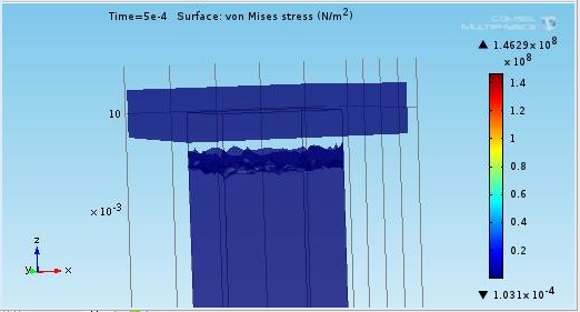

Posted: 1 decade ago 18 giu 2013, 03:46 CEST
My results look like attached file.
Even if I decrease velocity, contact part is torn off.
Any one has a idea?
My results look like attached file. Even if I decrease velocity, contact part is torn off. Any one has a idea?
