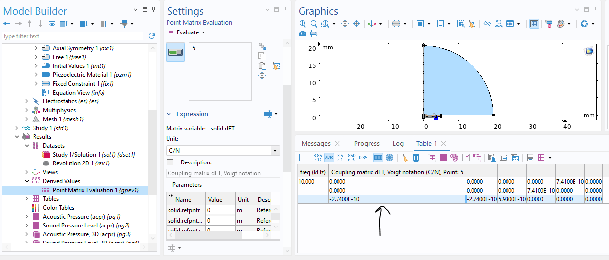

Hi Daniel, Yes, this is consistent notation for common piezoelectric materials like PZT which are poled along one axis.
As an example, I output the coupling matrix dET for PZT-5H from this model (https://www.comsol.com/model/piezoacoustic-transducer-1477). It matches the matrix with known d15, d31, and d33 material properties. See attached screenshot.
Best Regards, Mark
