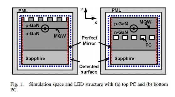

I tried to calculate the effects of photonic crystal on output efficiency of in LEDs. In published the paper, the light emiting layer source of dipole sources is suited for excitation, and it is always used as the radiating source of LED, in the file attached we can find that the circle is the dipole source, in this paper, the parameters of dipole source is :light wavelength is 465nm, full width at half maximum in 10nm,the absorption coefficient of GaN is 300cm-1 and photon lifetime is 320fs. I do not know how to set these parameters in Comsol. I tried to draw a point as the source but the point setting can only set the current.
I have not built models in Comsol for a period of time, so the version is old, thanks for your advice, and I will upgrade to the new version when this model is finished.
