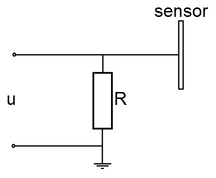

I build a small model of a capacitive sensor (small conducting plate). An electric dipole serves as the source of an electric field.
The field induces a surface current density at the sensor plate. But i cannot figure out how i couple this current with an attached circuit (see attached figure of circuit).
I tried lumped ports (electrical circuit module) and terminals (electric currents module), and coupled those with an external I vs U node.
But since the sensor only has one contact (one node, see figure) I don't think lumped ports and external I vs Us are approriate.
Would be nice if someone could give me a hint. Thanks.

Hi Rüdiger,
I have a couple of comments:
1. The ground you indicate in the circuit must some way have a counterpart in the model. The current must have a path to flow back into the geometry.
2. Your model dimensions are much smaller than the wavelength. A couple of cm versus 300 m at 1 MHz. So you should use AC/DC instead of RF. A PML is useless, you don't have waves in your model.
3. In AC/DC you should probably use terminals. You define your electrode as a terminal and you must define a ground in your model geometry
Cheers
Edgar
