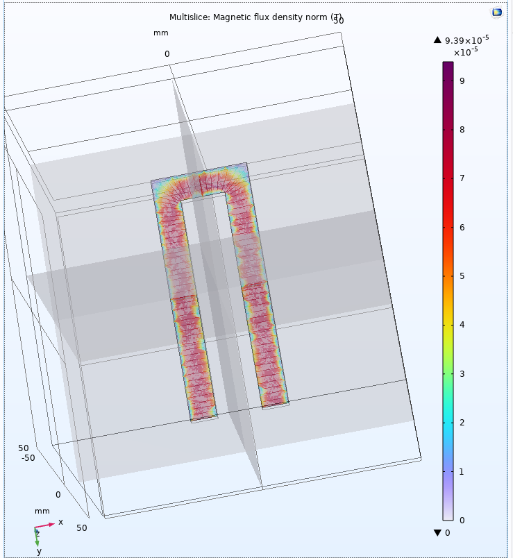

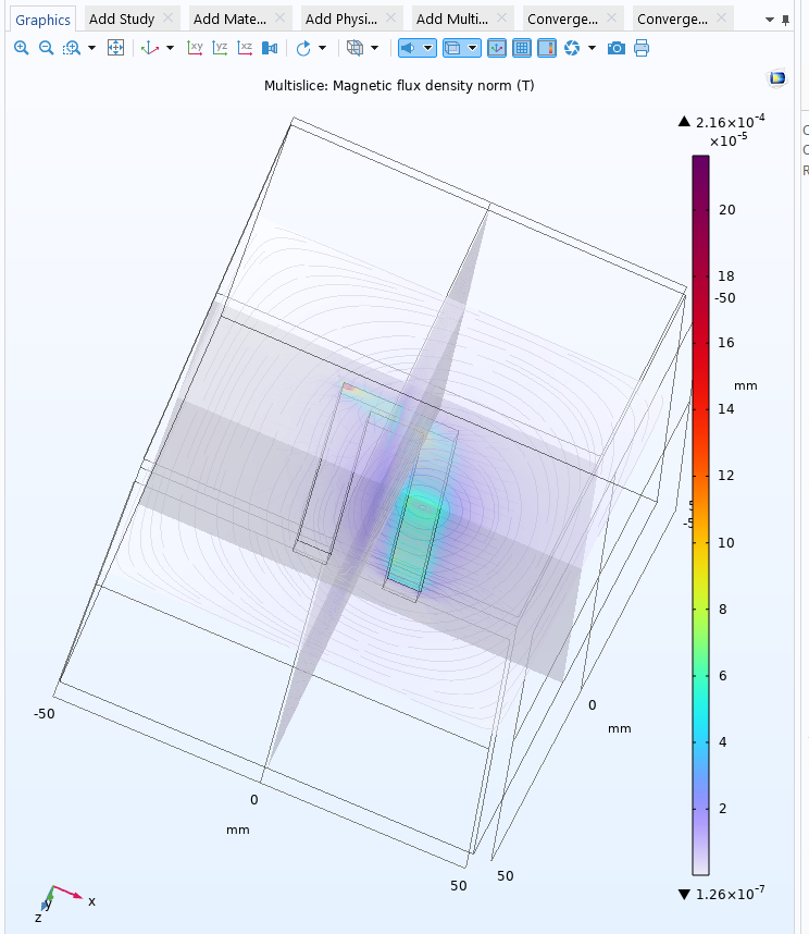

I am doing magnetic field study and made one U structure rectangular coil with an Air Domain. When I am forming a union, current is flowing is 1 or 2 legs of the coil and not in all 3,and forming magnetic field according to those conductors. When I am forming assembly, magnetic field is not being generated in Air but current is flowing in every conductor, How to resolve this issue!!!

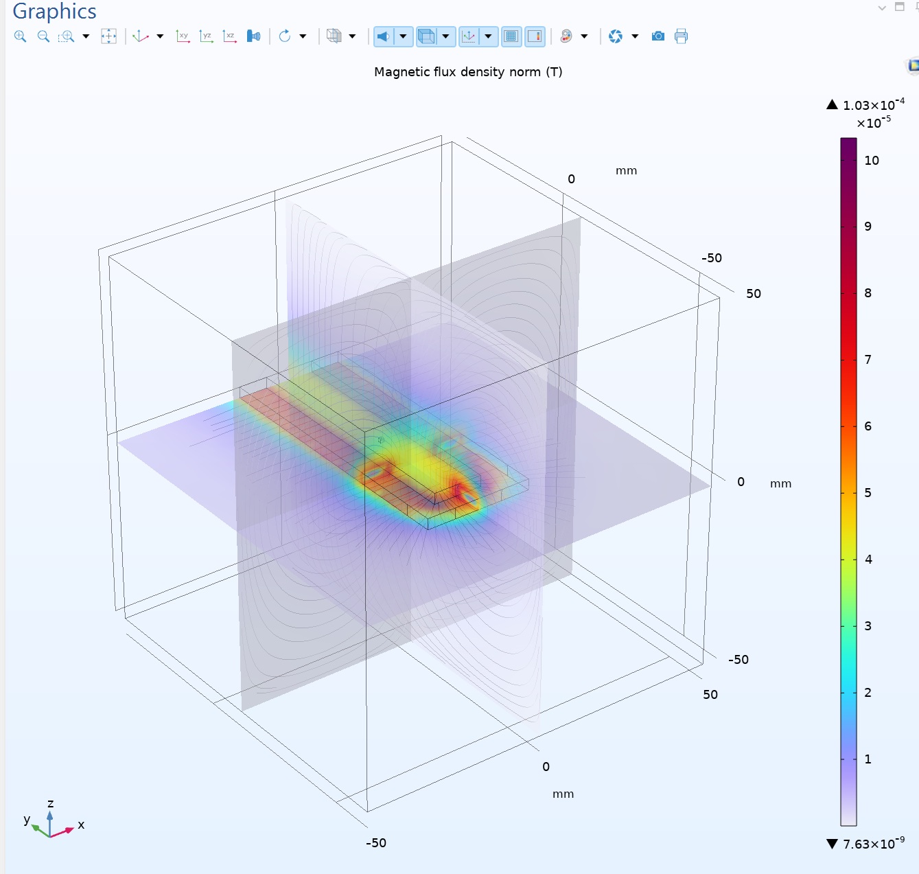

- I've attached a modified model (I cleared the solution to save space; you will need to execute it to see the results) that both solves and gives a meaningful picture (snapshot attached). But you may need to make additional changes, and possibly substantial ones, to get it to represent your real world problem (that is, assuming you are trying to model a real-world problem). I hope this helps.
