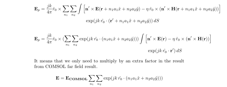

Yes! From the math structure of Stratton-Chu, I also found that a phase factor is necessary to solve it but my mates not always agree with me. Your advise is really helpful for my work. I will look at it to if there is a difference between my factor and that factor. Thank you again.

I want to know the factor af3() could be. I think it should be a complex number. But from the document, it seems a real number. Is there a source of the array factor?

I get it. They are totally the same.

Thanks for your reply! My idea is doing FFT - far field in frequency domain- doing IFFT. But I find their is already a Far-Field node in EW, Transient. Now I'm try to perform the convolution of FFT(array factor) in the time domain but I don't know if it works. I'm totally a green hand with COMSOL and I would be very grateful if you could offer an easy-going literature on transient.

I think of my models again. My model don't need to take array effect into account, so I can just apply far field node in EW, Transient. The other model only need to see the far field spectra in normal direction where array factor equals to 0 for all frequency, so far field of single unit is same as far field of array. I can still just apply far field node in EW, Transient there to get the far field spectra of array in normal direction.
