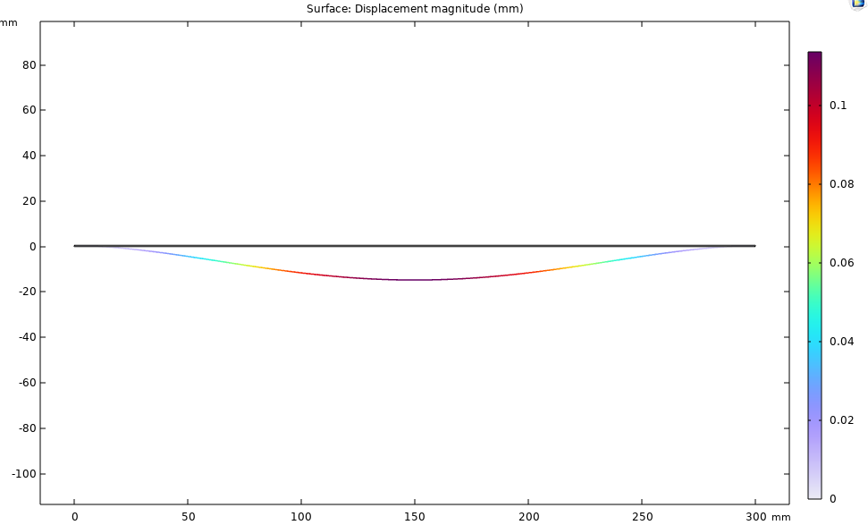

Why does 2D static deformation plot show displacement magnitude smaller than the Y-axis displacement?
In this model, the color-scale (displacement magnitude, ~0.1mm) deformation does not match the XY spatial deformation of the plot (~20mm). Can someone help me understand how the displacement magnitude is different from what is plotted in XY space?

Hello T,
It's because a scaling factor is applied to the displacements to render them visible in the graph. See, e.g., this thread or this one, etc...
Jeff Hiller
Hello T, It's because a scaling factor is applied to the displacements to render them visible in the graph. See, e.g., [this thread](https://www.comsol.com/forum/thread/83062/visible-deformations-in-wrench?last=2015-06-23T22:55:03Z) or [this one](https://www.comsol.com/forum/thread/290952/what-is-scale-factor-and-why-is-it-so-large?last=2021-06-09T18:17:09Z), etc... Best, Jeff

Thanks Jeff!
>Hello T, > >It's because a scaling factor is applied to the displacements to render them visible in the graph. See, e.g., [this thread](https://www.comsol.com/forum/thread/83062/visible-deformations-in-wrench?last=2015-06-23T22:55:03Z) or [this one](https://www.comsol.com/forum/thread/290952/what-is-scale-factor-and-why-is-it-so-large?last=2021-06-09T18:17:09Z), etc... > >Best, > >Jeff Thanks Jeff!
