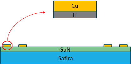

Thank you for the earlier tip about simplifying to 2D and adding the IDT pairs gradually—that really helped; my S11 looks much better now. However, S12 is still a nightmare. I suspect I’m doing something wrong with the boundary conditions and with how I model the metal stack. I’ve attached a sketch of the device (GaN on sapphire, Cu/Ti IDTs). In my stack, the Cu IDTs sit on a very thin Ti adhesion/barrier layer on GaN. The Ti is only for adhesion.
Questions:
What is the best way to treat the Cu–Ti and Ti–GaN interfaces in COMSOL? Should I keep Cu/Ti as solid domains for mass loading, or model the electrodes as PEC boundaries and account for mass with an equivalent metal thickness?
Is there any benefit to keeping the thin Ti layer explicitly in the model for S-parameters, or is it safe to lump Cu/Ti into a single effective electrode?
Any tips to improve S12 (e.g., absorbing boundaries/damping to suppress edge reflections, meshing, etc.)?
Thanks again for the guidance.
