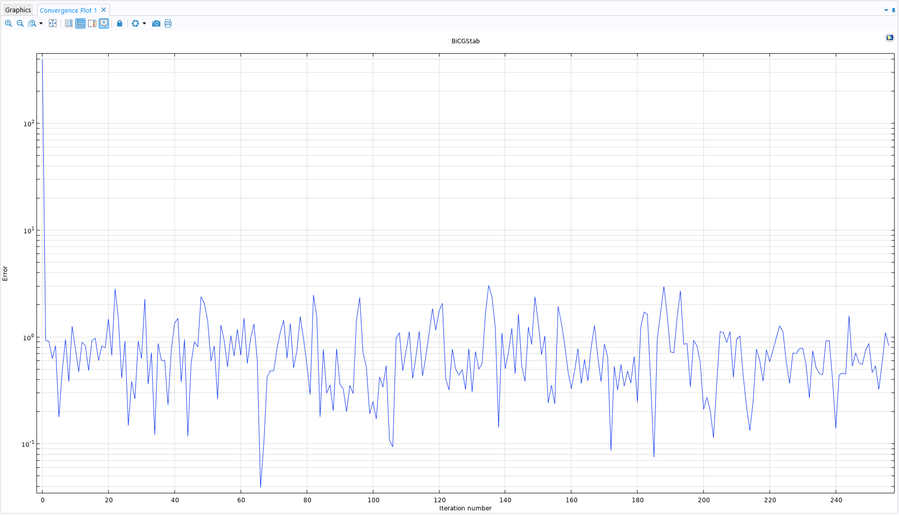

I am trying to model electric field shielding with a copper box that has some holes in it. I feel as though this should be a very simple simulation for COMSOL to run, but for some reason my convergence plot plateaus before the specified tolerance of the solver. I have tried doing very fine meshing, and this did not help.
Does anyone know what I can do about this?

in the ec physics the solver needs a non-zero conductivity in all domains, also in air. You can start with something as low as 1 S/m or lower as long you get convergence.
Cheers Edgar
