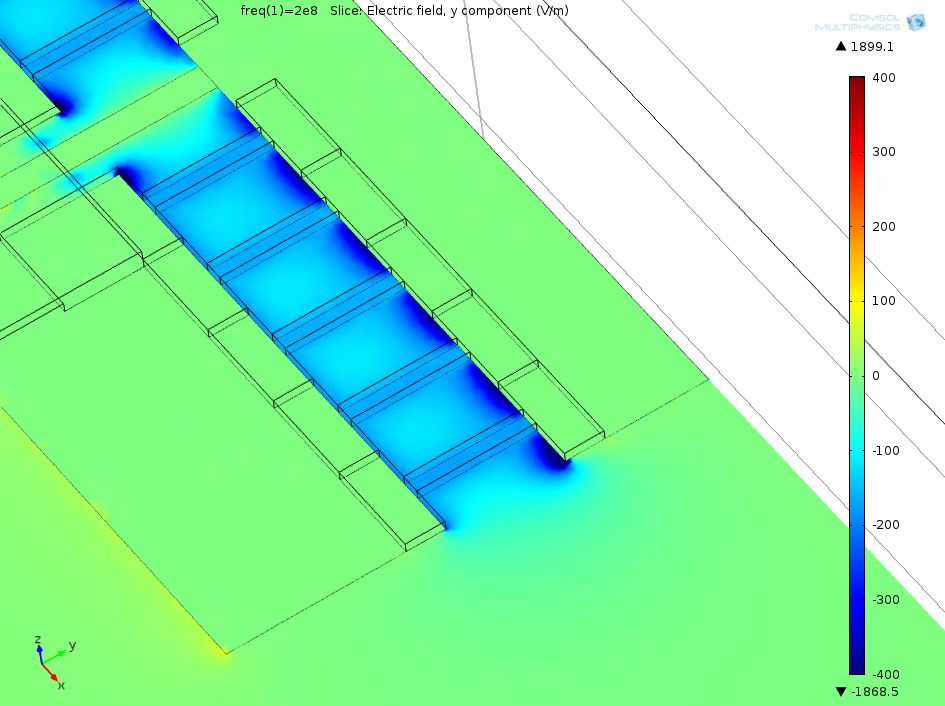

I have attached screenshots of d(V,y), and Y component of E field, respectively, plotted in the same plane. From my understanding, these should be equal, which is clearly not the case in my simulation.

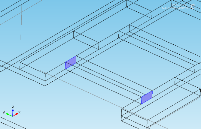

I have now run simulations at 1kHz and 10Mhz with boundary probes measuring average voltage on each end of a resistor. At 1kHz the difference is 0.83V, and at 10Mhz, it is -0.024V... Meanwhile, integrating the electric field over the length of the resistor gives 0.1V at both 1kHz and 10Mhz. So this confirms the slice plots in the PDF I attached earlier.
I have marked the boundaries that i probed for the voltage measurement in the attached image.

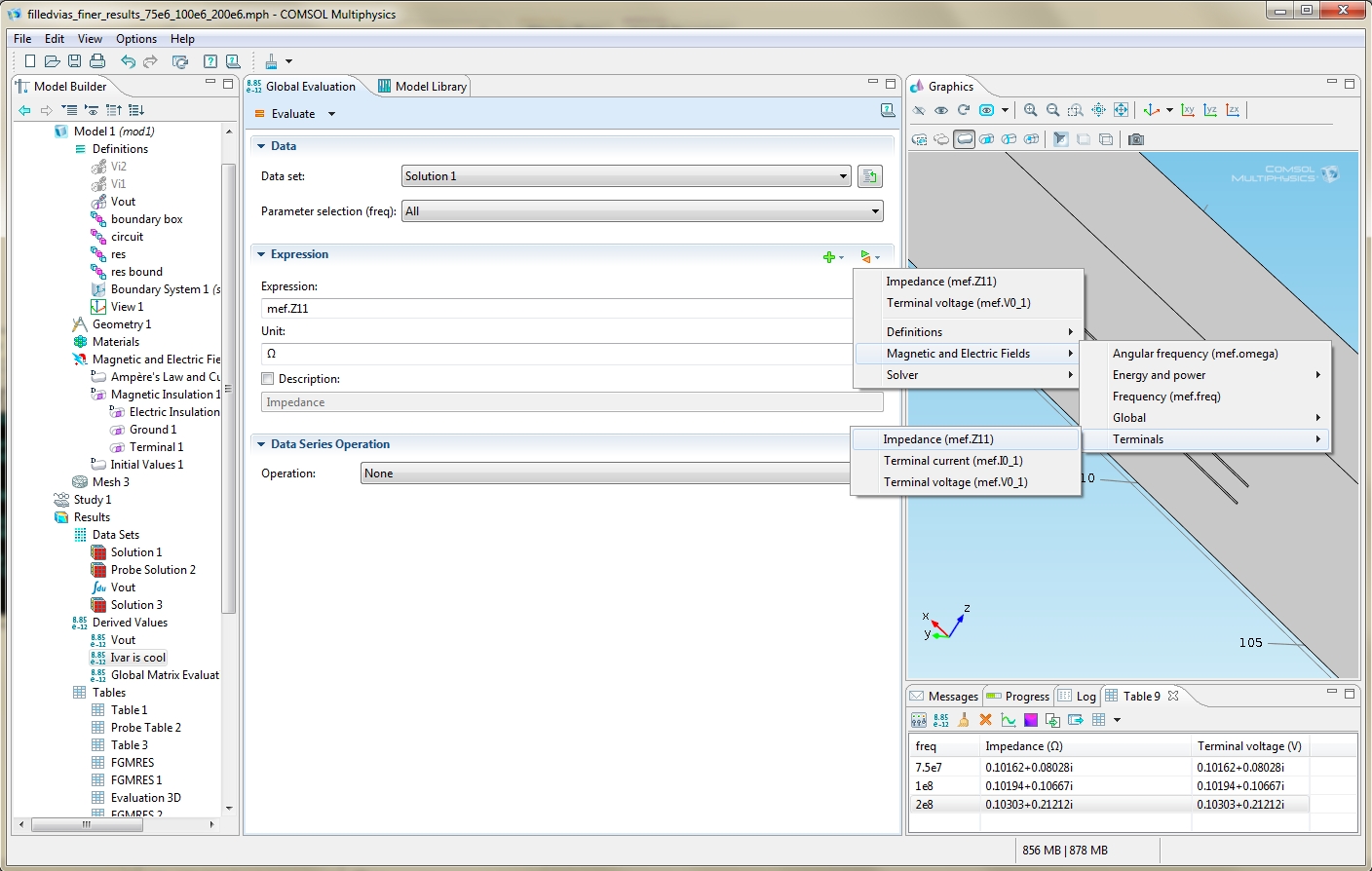

As far as I know, mef only gives acces to the terminal complex impedance - see attached screenshot.
At 200MHz, i get Ω = 0.10303+0.21212i, suggesting that the circuit is predominantly inductive.

As far as I know, mef only gives acces to the terminal complex impedance - see attached screenshot. At 200MHz, i get Ω = 0.10303+0.21212i, suggesting that the circuit is predominantly inductive. Rough inductance calculation based on simple vertically spaced tracks formula: [math]L=\frac{\mu l h}{w} \leftrightarrow L=\frac{\mu_0 (2mm \cdot 0.36mm)}{5.45mm} = 166 pH[/math] At 200Mhz, this gives: [math] \Omega = 2 \pi f L i = 0.208i \Omega [/math] Which corresponds well with the lumped port impedance from comsol. (Edit: When I earlier mentioned that the imaginary component of the fields was negligible, I was referring to the results at 1MHz and 10Mhz, which still show the spurious V field as shown in the pdf.)

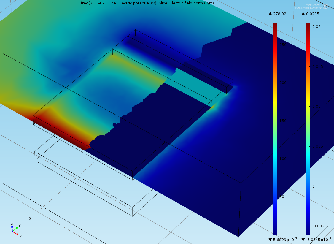

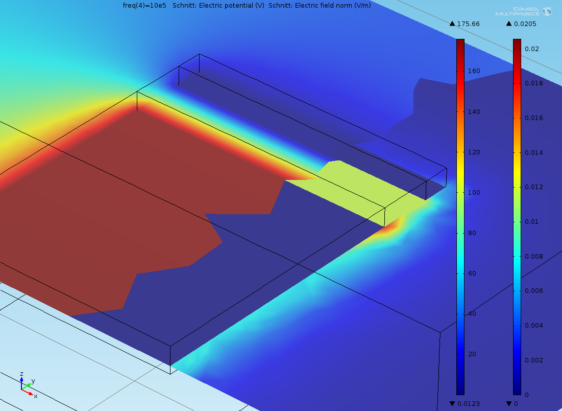

And here we go!
I made a simplified geometry, and the discrepancy between V and E persists!
Check it out, the attached screenshot shows a comparison of the V field and E field at 500kHz, made by applying complementary filters to the slice plots of V and E.
Also attached is the cleared model, it took 5 mins to sweep four frequencies on my workstation, but that is because I made the mesh quite fine in order to accurately resolve the skin depth (I wanted to rule this out as a possible cause). You can just change to a fine physics derived mesh and it will run much quicker, with not much different results.
Looking forward to hearing what you think :)

You should add "gauge fixing for A-field" to your Ampere's Law; only this will give you a correct potential calculation.
The E-field is already ok.
Ralf
Hello! You should add "gauge fixing for A-field" to your Ampere's Law; only this will give you a correct potential calculation. The E-field is already ok. Ralf
