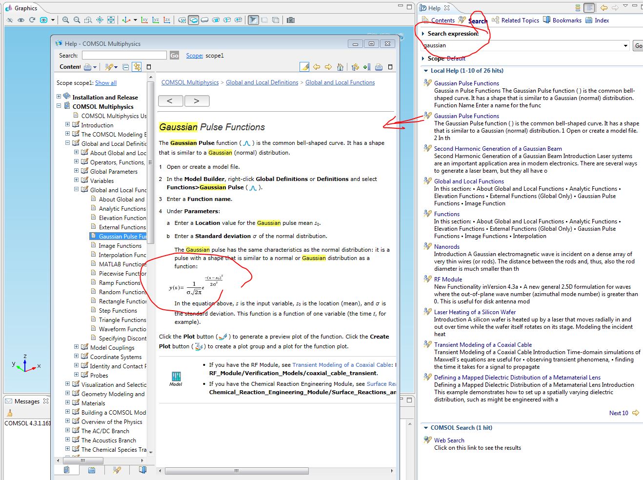

Posted: 1 decade ago 3 mag 2013, 11:04 GMT-4
looks like this ;)
v4.3a.161
Hi looks like this ;) v4.3a.161 -- Good luck Ivar
Posted: 1 decade ago 13 mag 2013, 07:58 GMT-4
Thank you for your screen but i think that i read this page like 20 times and nevertheless i'm not getting any wiser, that's the analytical expression of the gaussian and not the way i should write it (normalisation) on Comsol but nevermind thank you for your time and your help, I hope I'll have my enlightenment moment.
