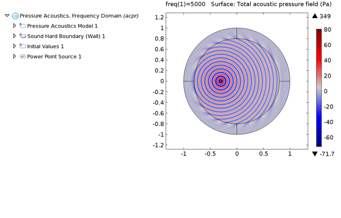

To insert acoustic point source, right-click Pressure-Acoustics, Frequency Domain node and select Points>Power Point Source. You can specify point source by power, flow rate, or intensity.

Dear Mr Sergei,
Thank you very much for your replying.
