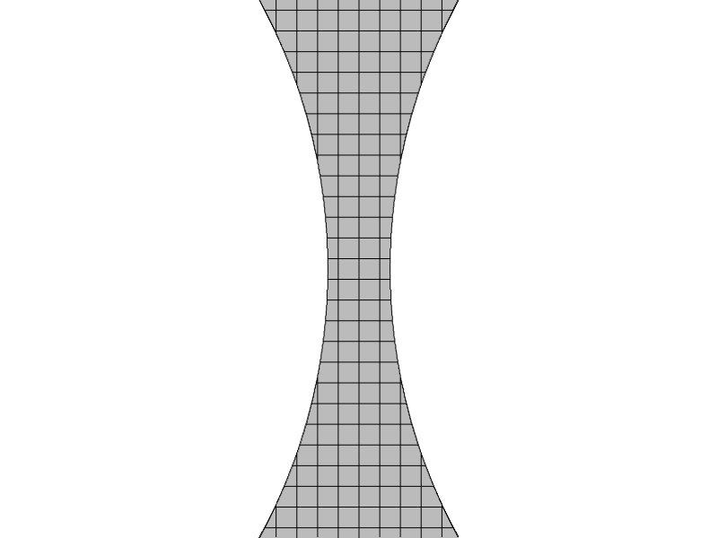

i want to make a script (matlab) to impose a local young's modulus on many subdomains (attached image of my subdomain)
someone have any idea how to make it ?
thank you very much

Hello Tarik,
You typically call an interpolation function of x and y.
The example "aquifer characterization" from the Subsurface Flow module is the closest COMSOL has for imposing a function that is mesh dependent like yours.
www.comsol.com/showroom/gallery/4410/
The principle of using interpolation function is used in the simpler "rock fracture flow" available with the basic package. Note that in such case the function is not mesh-dependent.
www.comsol.com/showroom/gallery/101/
I'll send you a bit more details elsewhere.
Good luck,
Eric
