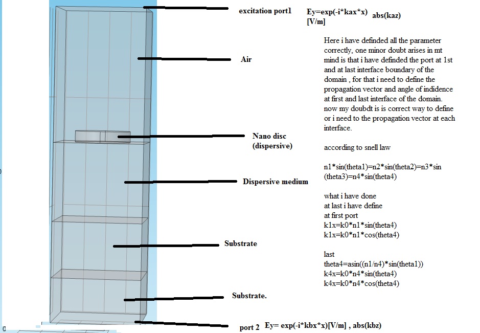

1. Variable part : In my domain i have used silicon which is a dispersive material, for that i have used the interpolation function and upload the txt file. it was work nice, my question is how will check whether my data is taking at time of simulation or not.
2. Regarding the define the wave vector and propagation constant in the variable domain.
here i have used a multilayer system, at each interface the wave vector and angle of incidence get changed , my question is i need to define the propagation constant at each interface as i have defined the port at the extreme interface of my domain.
as i know for a multilayer system obey snell law, so
n_air*sin(theta1)=n_2*sin(theta2)=n_3*sin(theta3)
now sin(theta3)=asin(sin(theta1*(n_air/re(n_2)))
after that i have defined as respective propagation vectors
k1x=emw.k0*sin(theta1), kaz=emwk0*cos(theta1) this is defined at the excitation port 1
exciation field
Ey= exp(-i*k1x*x)[V/m], propagation constant= abs(k1z)
Similarly in other port 2
k4x=emw.k0*sin(theta3)*re(n_2), k4z= emw.k0*cos(theta3)*re(n_2)
Ey= exp(-i*k4x*x)[V/m], propagation consatnt= abs(k4z)
PBC and PEC Bounadry condtion chosen at necessary interface.
in between i have not defined any thing , could you suggest me my parameter setting is wright or wrong.
