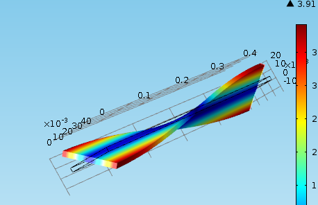

Posted: 1 decade ago 16 feb 2014, 17:15 GMT-5
I am back to this matter again. I put the mass and the forces to the Rigid connector node as Ivar suggested, but I am not sure how to define the restraints. With "prescribed displacement" node I usually check the displacement in the z direction to be zero.I tried the same here (the others unchecked) and the prescribed rotation left it free.
However, the 4th frexural mode I get is the one in the picture I attached (I also attached the model), and I think that's not a proper mode for a simple support boundary condition (is it?).
Please give it a try and check it out, I am really curious to compare the results of the rigid connector vs prescribed displacement.

Posted: 1 decade ago 17 feb 2014, 07:40 GMT-5
In addition to that, I just found out that the rigid connector is not available in the Plate element. I can assume that this is because of the thickness? (although Comsol says that can calculate Midlin Plates too)
So here we have only the options of Prescribed displacement/Pinned, however Ι think I'm not sure about the role of the prescribed rotation regarding the simple support boundary condition.
In addition to that, I just found out that the rigid connector is not available in the Plate element. I can assume that this is because of the thickness? (although Comsol says that can calculate Midlin Plates too) So here we have only the options of Prescribed displacement/Pinned, however Ι think I'm not sure about the role of the prescribed rotation regarding the simple support boundary condition.
