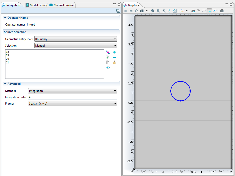

Posted: 1 decade ago 8 apr 2013, 03:51 CEST
When I do this I get a force/m which is a few magnitudes smaller than what you get. I think my integration might be incorrect. If I understand correctly I want to integrate over a surface with the normal point radially outward from my sphere in 2D. A line integral will only integrate along the line. If I use a surface integral in 2D it doesn't seem to make sense to me.
I've attached pictures of my attempt but I don't know how I can get Comsol to do what I want. When I do this I get a value of 2.8*10^-10 N/m
Thanks,
Mark.
When I do this I get a force/m which is a few magnitudes smaller than what you get. I think my integration might be incorrect. If I understand correctly I want to integrate over a surface with the normal point radially outward from my sphere in 2D. A line integral will only integrate along the line. If I use a surface integral in 2D it doesn't seem to make sense to me. I've attached pictures of my attempt but I don't know how I can get Comsol to do what I want. When I do this I get a value of 2.8*10^-10 N/m Thanks, Mark.
Posted: 1 decade ago 8 apr 2013, 06:57 CEST
when you perform a 2D simulation, the default depth is 1 meter (for the 3rd dimension as COMSOL calculates always in 3D in the background), hence all surface integration need to be multiplied by the true depth to give absolute values, else they are expressed as "per meter" hence the N/m
for 2D-axi going from surface integration to volume integration requires to multiply by the "loop length" hence by 2*pi*r
Hi when you perform a 2D simulation, the default depth is 1 meter (for the 3rd dimension as COMSOL calculates always in 3D in the background), hence all surface integration need to be multiplied by the true depth to give absolute values, else they are expressed as "per meter" hence the N/m for 2D-axi going from surface integration to volume integration requires to multiply by the "loop length" hence by 2*pi*r -- Good luck Ivar
Posted: 1 decade ago 9 apr 2013, 03:25 CEST
Thank you for your reply. I remember reading that Comsol does simulations using a depth of 1m. But for my simulation would it not just assume a circle was projected into a cylinder rather than a sphere? Is this the difference between 2D and 2D axisymmetric?
Either way I cannot reproduce the value obtained by Sergei. I'm concerned with my choice of integration boundaries and if it is possible to do a line integration where the line element is a vector pointing 90 degrees to it's direction as opposed to along the line?
Thank you for your time,
Mark.
Hi, Thank you for your reply. I remember reading that Comsol does simulations using a depth of 1m. But for my simulation would it not just assume a circle was projected into a cylinder rather than a sphere? Is this the difference between 2D and 2D axisymmetric? Either way I cannot reproduce the value obtained by Sergei. I'm concerned with my choice of integration boundaries and if it is possible to do a line integration where the line element is a vector pointing 90 degrees to it's direction as opposed to along the line? Thank you for your time, Mark.
