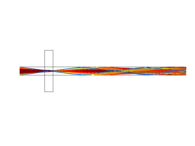

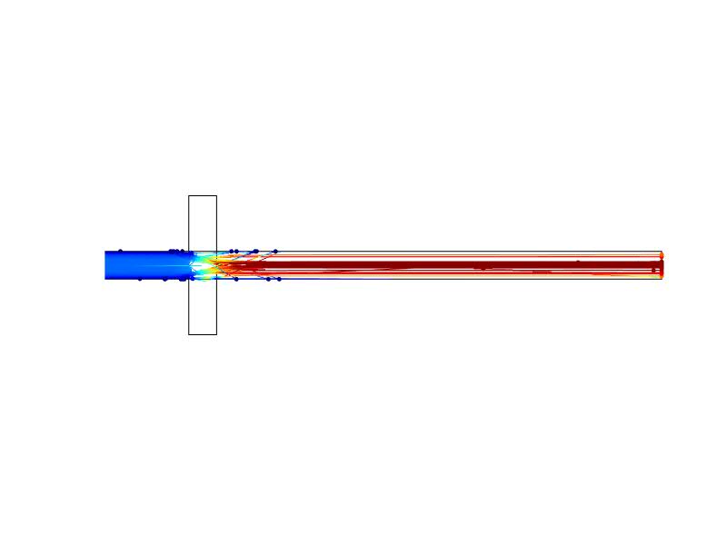

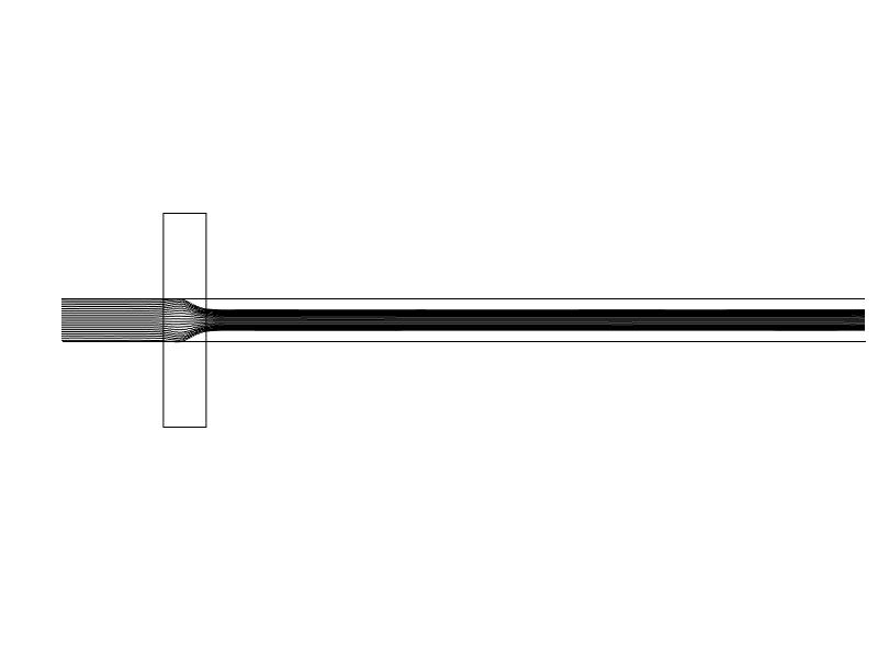

I'm trying to teach myself how to use the particle tracing module, so I'm modeling a simple T-junction microfluidic channel. I get an unexpected result, however, when I trace the particles. Since it is a microchannel, I expect the particles to follow streamlines. However, they do not (see attached). I've tried both the Newtonian and massless configurations. This is a 2D, incompressible model, assuming a shallow channel of 30 um. Could anyone lend any insight into what's happening or which results I should trust?

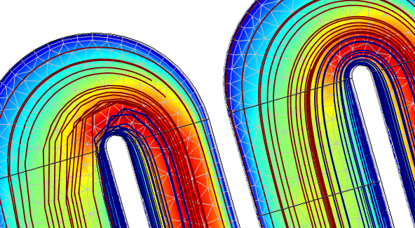

Also, I have experienced something odd, in my own model which is a periodic structere (spline) where I have mapped the velocity field solution from one unit onto the other units in the geometry. I then used this mapped solution in a particle trace study with massless particles. In the first loop/arch of the spline, the particle trajectories are jagged and weird, while in the next, they are nice and smooth (see the attached snapshot), even though the fluid fields they move in, and the time steps used in the solver, are completely identical. What is happening here?
