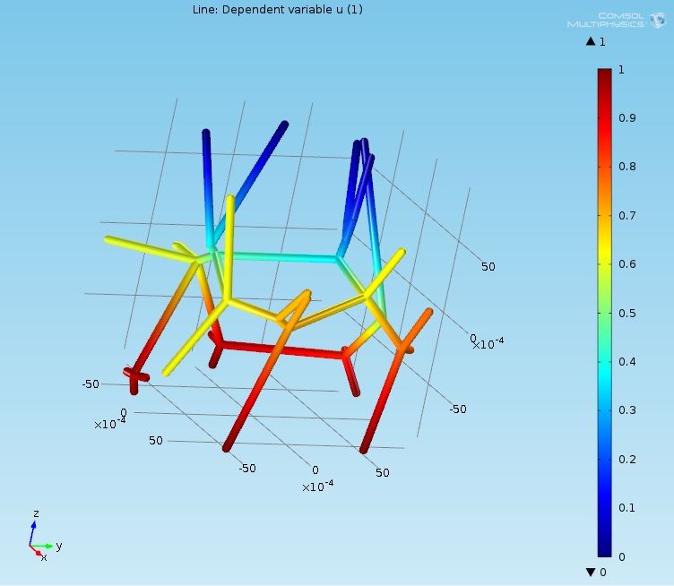

I have a network of 1D elements and I have modeled the current flow inside them using Coefficient from edge PDE. So after running the model I have the voltage in all the structure as shown in the picture.
now I need to calculate current in each branch of the structure. I'm wondering how I can do this. I know that current can be shown in a plot by:

Posted: 1 decade ago 25 mar 2013, 14:45 CET
as the cross section is constant we have constant current through each line, so I was thinking to use point evaluation but I need help how to do it.

Sven Friedel COMSOL Employee
Posted: 1 decade ago 26 mar 2013, 11:47 CET
Dear Ehsan,
what do you mean by "derive it"? Would you like to export the data as txt file, display the values graphically ... ?
Please note that tangential derivatives are not defined in points but only on edges, because points have no tangent.
There is however a way to derive the current in a point "on the side of a neighbroung edge".
Take for instance in the model I sent earlier and attach here again point 7. It is connected to the edges 10, 12 and 7.
If you want to know the current in point 7 on the side of edge 12, you can access that by using a point evaluation for the expression
side(12,sqrt(uTx^2+uTy^2+uTz^2))*(rho/A)
I have addeed that to the file attached. Hope that helps.
Sven Friedel
Dear Ehsan, what do you mean by "derive it"? Would you like to export the data as txt file, display the values graphically ... ? Please note that tangential derivatives are not defined in points but only on edges, because points have no tangent. There is however a way to derive the current in a point "on the side of a neighbroung edge". Take for instance in the model I sent earlier and attach here again point 7. It is connected to the edges 10, 12 and 7. If you want to know the current in point 7 on the side of edge 12, you can access that by using a point evaluation for the expression side(12,sqrt(uTx^2+uTy^2+uTz^2))*(rho/A) I have addeed that to the file attached. Hope that helps. Sven Friedel
