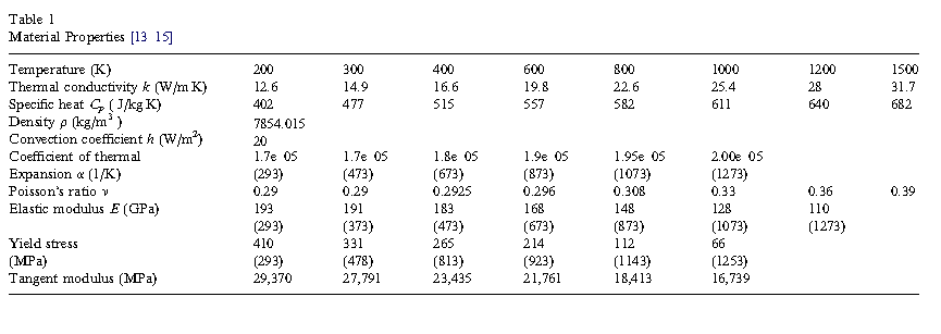

dear ivar,
Thanks for your reply.i used temperature dependent properties by using interpolation function.but i am getting 700mpa von mises stress .but stainless steel ultimate tensile strength is 515 mpa.
i used interpolation function.but what is higher order setting??
can you help me?
dear ivar,
can you help me?

Dear ivar,
sorry for my explanation. this is my final result Von mises stress value about 700 Mega Pascal. von Mises stress I got from Comsol too high (>>yield strength of materials) than I expected.
Dear ivar,

The ultimate tensile strength of the material is not accounted for in the elastic-plastic material model you are using. Therefore if the strains are high enough you can get stresses around 700 MPa. That would require a very large temperature increase though and an overly constrained structure. What temperature increase are you applying? Check also that you are using an elastic-plastic material and not just elastic.
Nagi Elabbasi
Veryst Engineering
