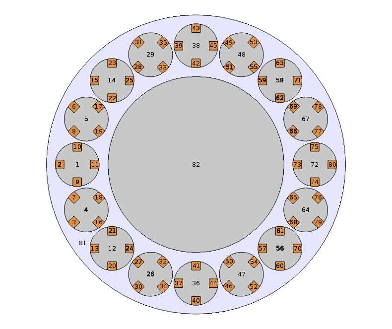

The model has 16 electromagnetic poles with a pair of coils in quadrature wound on silicon steel.
So I have 32 coils each 90 turns.
I need to do the following:

Generally my problem is similar to an assembly of inductors which produce flux similar to
a magnetic Halbach array.
Find the geometry attached (orange colored regions are coils, the grey regions are the
iron cored parts, the faint purplish color is defined as air).
I was able to import a 2D dxf file and I can also add the materials
(a) How can I view the domains and do I need to split the geometry to parts so that I can associate parts of the same material?
Regards and I hope you will assist me since am in the introductory stage.

Posted: 1 decade ago 14 mar 2013, 09:06 CET
A challenging problem ;)
but if your signal is periodic, will it not be simpler to consider a frequency domain solver, you then define the amplitude and phase per coil sets ?
