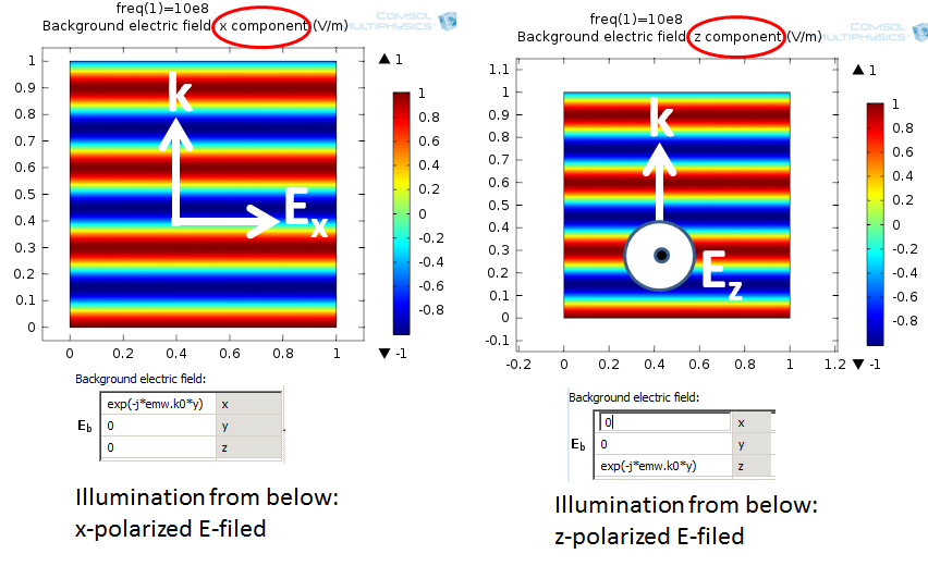

I want to create a 2D geometry but illuminate it from below, or out of plane, with a plane wave. Whenever I try and set the Background Field as exp(-i*emw.k0*z) (in x direction) I get errors as it fails to evaluate the variable z.

If 2D geometry is illuminated from below, then wavevector is k={0,k0,0}, meaning that wave is propagating along y-axis.
For plane wave, electric and magnetic fields are normal to the propagation direction. Hence, you have two choices: electric field can be x-polarized or z-polarized.
For x-polarization, background electric field is defined as E={exp(-j*emw.k0*y,0,0)}.
For z-polarization, background electric field is defined as E={0,0,exp(-j*emw.k0*y,0,0)},
as illustrated in the attached plot.
Sergei

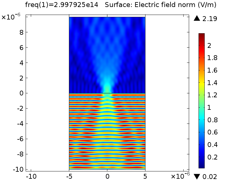

2. Back to your problem. You case of x-polarized incident wave propagating in the z-direction is:
k={0,0,kz}, E={exp(-j*kz*z,0,0)}, H={0,exp(-j*kz*z),0}.
Boundary conditions are as following.
At boundaries x=const: PEC or Continuity type of periodicity.
At boundaries y=const: PMC, since magnetic field is normal to these boundaries.
At boundaries z-const you have two choices: use PML layers if Scattered Field formulation is used, or use Port boundary conditions if Full Field formulation is used (with excitation field E={exp(-j*kz*z,0,0)} and propagation constant beta=kz)
Attached is field distribution obtained using Scattered Filed formulation for periodic array slits in 2D case.
Sergei
