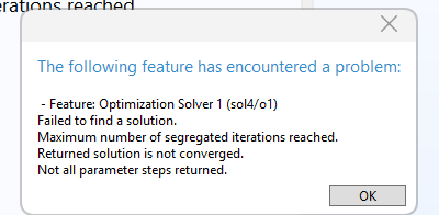

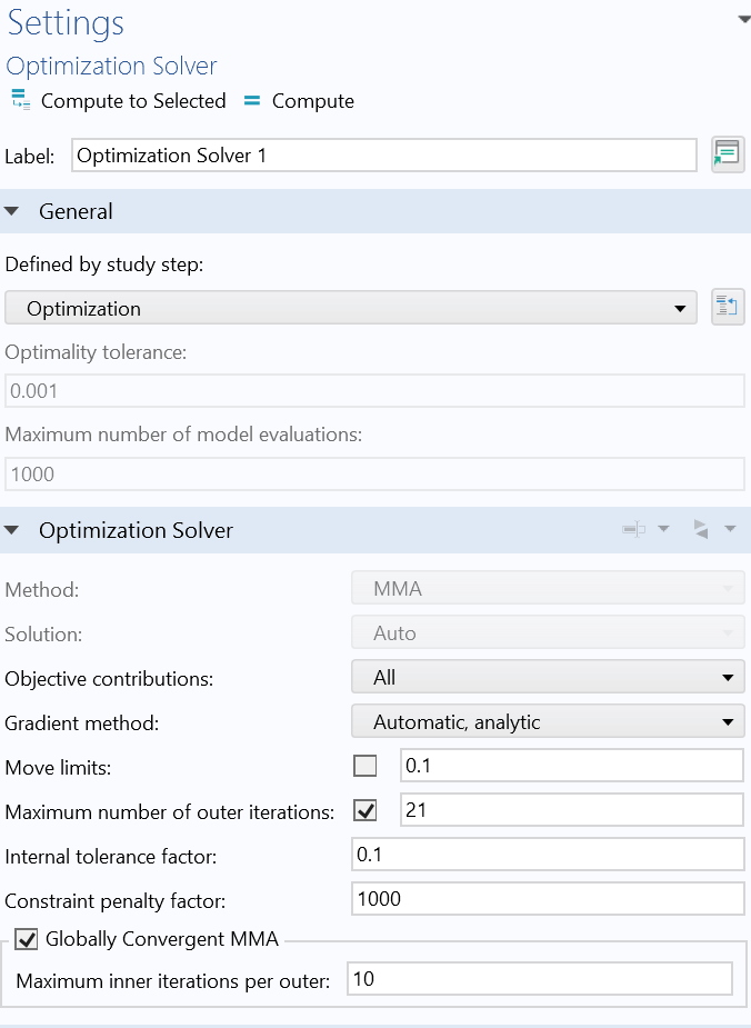

Hi Everyone, I am working on a Topology Optimization setup of model (that consists of two materials) that undergoes Induction Heating(Physics involved: electromagnetic heating) in two step study ( Step1: Coil Geometry analysis, Step2: Frequency-Transient Solver, the optimization is applied for step 2). I have setup the settings for the required density model for topology optimization as following: theta_min: 0.01 theta_initial: 0.5
Control Variable Constraints: 0.9>=theta_average>=0.5 The optimization(MMA solver) starts properly at first iteration, but after that depending on the initial value given, after some iterations, I start getting this "Warning: Forward solution failed, requesting reduced step." This persists continuously and eventually I have to cancel the compute.
I would really grateful any help and please let me know if you need any further information regarding this.

Hi Ashok
If the behavior is deterministic, you can terminate the optimization solver on iterations, so that it stops for the controls that cause the problem.
You can then initialize a another study without optimization based on those "bad" controls and investigate the issue in a more time efficient manner. Alternatively, it might be possible to stop the computation by clicking the stop button next to the optimization solver on the progress tab (and waiting).
It sounds like the problem is nonlinear and the solver fails. You can change the nonlinear method on the solver configuration and enable plot while solving on the solver to get more information. Movelimits, larger filter length (or no filter), or better scaling are other possible solutions.

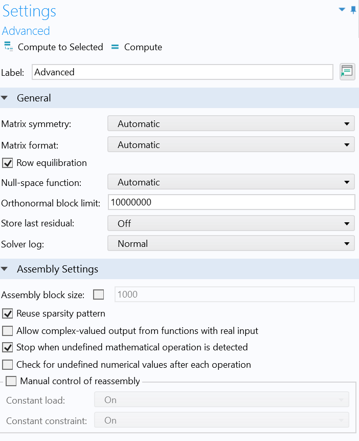

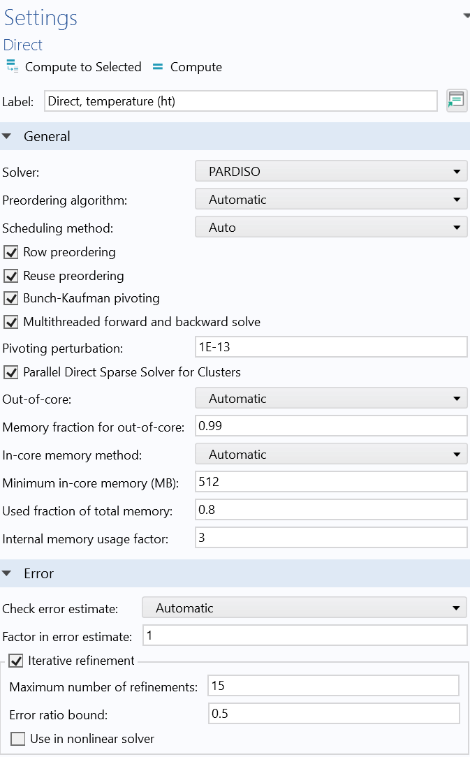

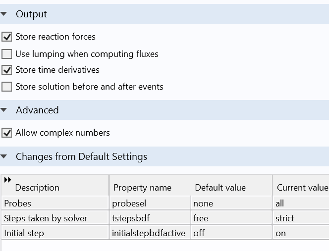

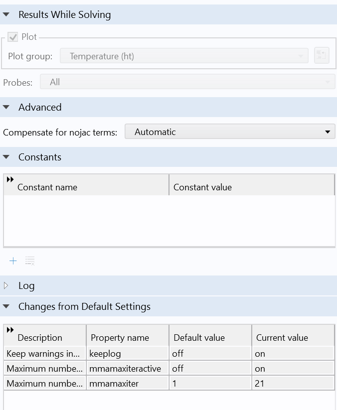

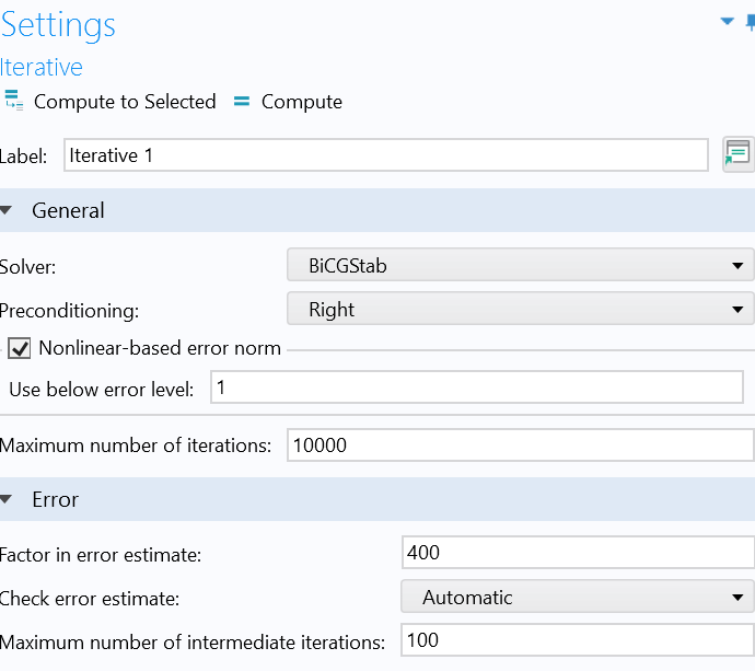

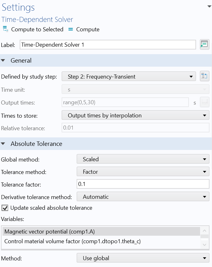

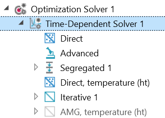

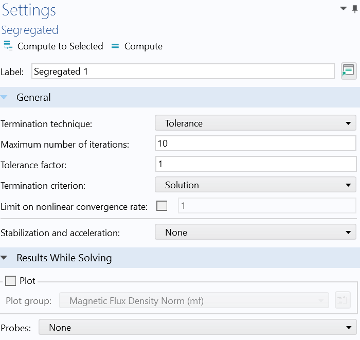

Hi Kristian, Thank you for your reply.
I believe I am using the linear solver, and think the forward solution warning appears during the "advanced" solver step as once the segregated solver starts, there will be a objective function result but if the advanced solver step has problem moving forward, I believe thats when the warning appears based on my observations. Right now, I am trying with stricter time steps(inital time step: 0.001) and manual absolute tolerance(0.001) in time solver and am attaching the screenshots of solver and solver config settings, so please go through them and let me know any recommended changes or things causing the issue(most of them are default settings).
Once again, I am really grateful any help and please let me know if you need any further information regarding this.

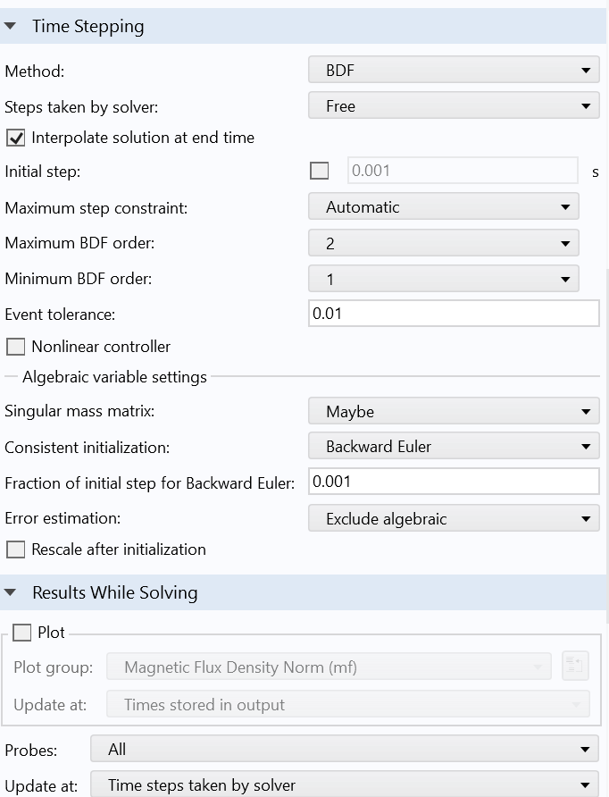

My apologies: The Frequency-Transient study step obviously generates a time dependent solver.
Lowering the order of the time integration can also improve robustness. If you are not using the v6.3, this can also be the reason, because accuracy, robustness, and performance was improved significantly in the latest release due the introduction of a new sensitivity computation algorithm (time discrete as opposed to the old time continuous adjoint).

Hi Kristian,
I am using 5.6. Any recommended settings you would give so that I can not have this issue. Currently I am trying with move limits as you suggested.

Hello Kristian, Based on what you said, I think it's sensitivity based error cause when I just run the solver by disabling Optimization at the iteration where the warning started occurring, there was no issue as the Normal forward solution worked properly. I will try to run this in higher version but any suggestions for this "checkpointing/sensitivity" you can recommend, using move limits I was able to increase the iterations but error persists. The highest iteration right now I have is 9, If I can get it to around 20 or something is fine for now.
