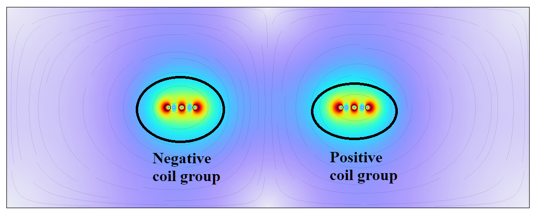

Hello Robert Koslover, thank your for your reply. I am trying to implement the simulation as per your valuable inputs. however, I am having the following doubts regarding the simulation results:
  1. I am already using magnetic insulation boundary condition with (del.A = 0) in three sides Now, how to incorporate the fourth side (See the figure attached), to consider the magnetic field of negative coil group in the simulation.
I know that (del.A = 0) condition will keep all the flux inside the solution domain. Now, how to consider boundary condition for fourth side.
Hello Robert Koslover, thank your for your reply. I am trying to implement the simulation as per your valuable inputs. however, I am having the following doubts regarding the simulation results: 1. I am already using magnetic insulation boundary condition with (del.A = 0) in three sides Now, how to incorporate the fourth side (See the figure attached), to consider the magnetic field of negative coil group in the simulation. I know that (del.A = 0) condition will keep all the flux inside the solution domain. Now, how to consider boundary condition for fourth side.
Posted: 9 months ago 23 apr 2025, 13:02 GMT-4
There is a left-right symmetry to the problem. If you compute the fields on one side, then now you know everything about both sides, because the missing side is simply the mirror image of the side in which you did the computations.
FYI, setting a magnetic insulation boundary condition is not the same as setting divergence of A = 0. Rather, magnetic insulation corresponds to setting to zero the component of the magnetic field (H) that is normal to the boundary. This becomes n cross H = 0 at the boundary, where n is the normal vector to the boundary.
There is a left-right symmetry to the problem. If you compute the fields on one side, then now you know everything about both sides, because the missing side is simply the mirror image of the side in which you did the computations. FYI, setting a *magnetic insulation* boundary condition is not the same as setting divergence of A = 0. Rather, magnetic insulation corresponds to setting to zero the component of the magnetic field (H) that is normal to the boundary. This becomes n cross H = 0 at the boundary, where n is the normal vector to the boundary.
