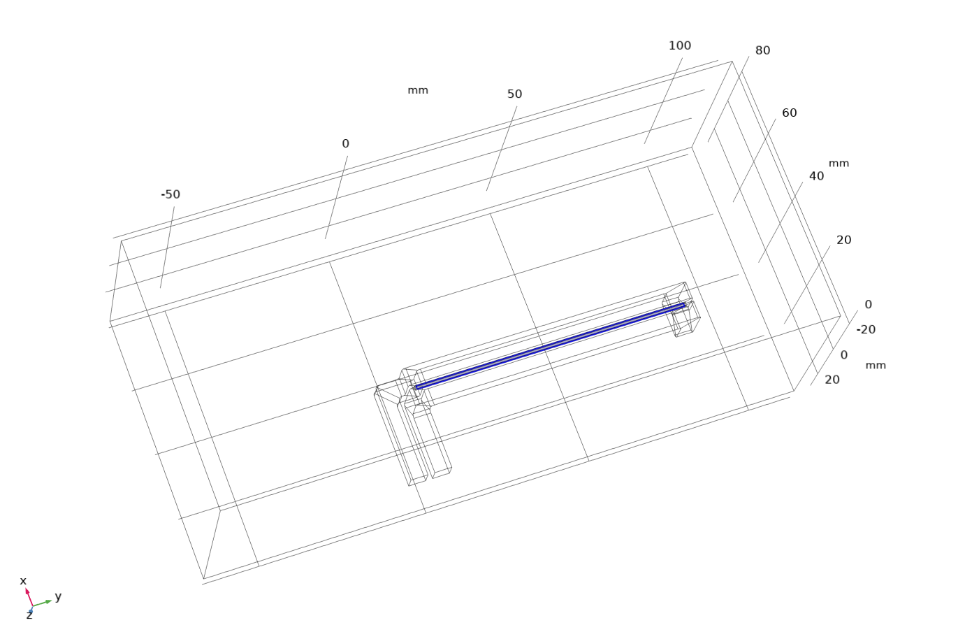

I am encountering difficulties in simulating an induction heating process and would appreciate your guidance. The configuration consists of a U-shaped single-turn coil carrying AC current to heat a soft magnetic material plate via induction.
The key technical issue is: When defining the soft magnetic material's constitutive relation using a BH curve, frequency-domain analysis becomes unavailable. However, when switching to transient calculation, I cannot apply current excitation to the single-turn coil. Attempting voltage excitation results in severe convergence issues.
