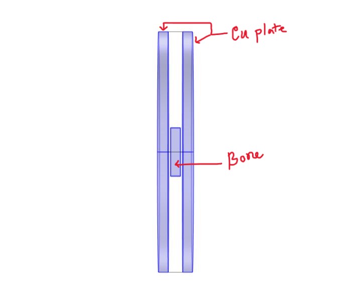

Hello experts,
I am trying to heat a block (bone) between parallel copper plate. The plate is 5 cm in diameter and 0.2 cm in height. The block dimension 1x1x0.2 cm. I read a research paper who solved similar problem (attached). They mentioned using EM Waves, frequency domain and heat transfer modules. For the power input 100 W for 50 ohm impedance. Peak voltage input 100 V. They also mentioned using lumped port. Which surface should I select as lump port? Should I select uniform lump port? How can I solve the problem based on your opinion? Source file attached. Thanks in advance.
