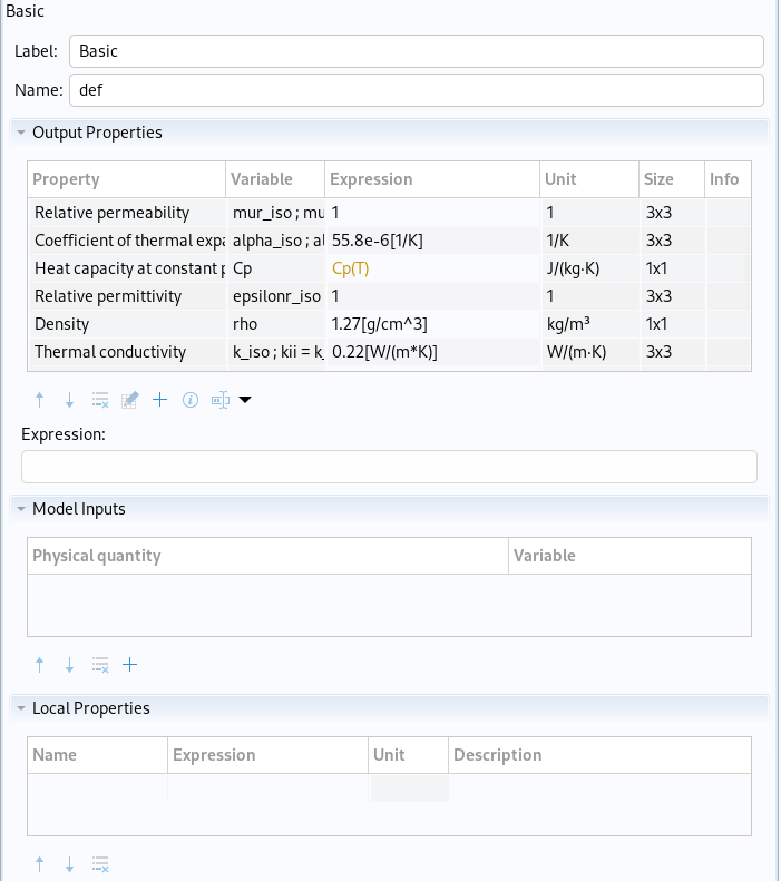

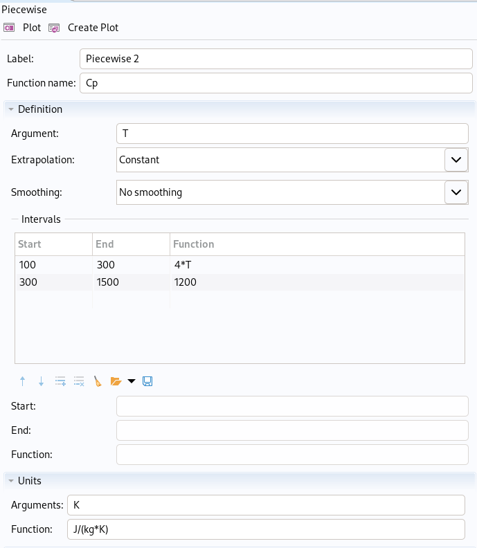

I'm testing incorporating variable material properties into my model with a piecewise function but am getting errors when I try to run it. Is this the correct syntax? When changing the material property to the function argument it goes yellow.
Here are images of my view from a specific heat function.

If you hover over the orange colored (which indicates problem) text, maybe an error text pops up.
I think you can't use T there as used. The used function argument name T only exist inside your piecewise function. From outside you must use a constant or a variable, which exists outside.
Or Cp as variable name and Cp also as function name is a problem.
Nice greetings
If you hover over the orange colored (which indicates problem) text, maybe an error text pops up. I think you can't use T there as used. The used function argument name T only exist inside your piecewise function. From outside you must use a constant or a variable, which exists outside. Or Cp as variable name and Cp also as function name is a problem. Nice greetings
